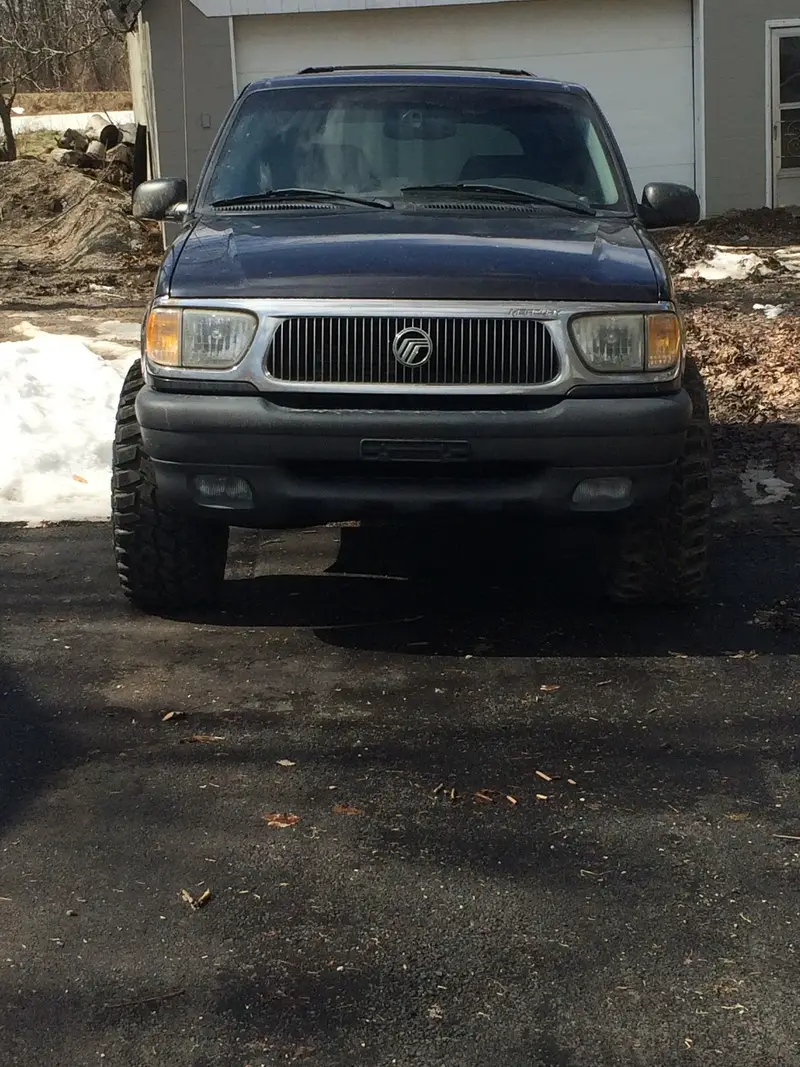

Still in the boring collecting parts stage. Probably start pulling the Mount apart in April. I am currently looking for tires in the 38-40" Range.

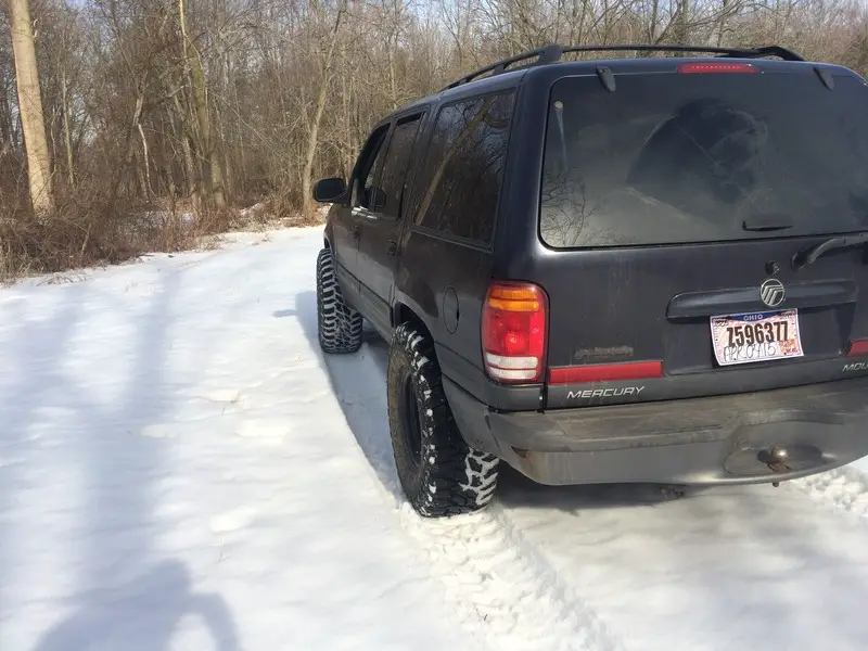

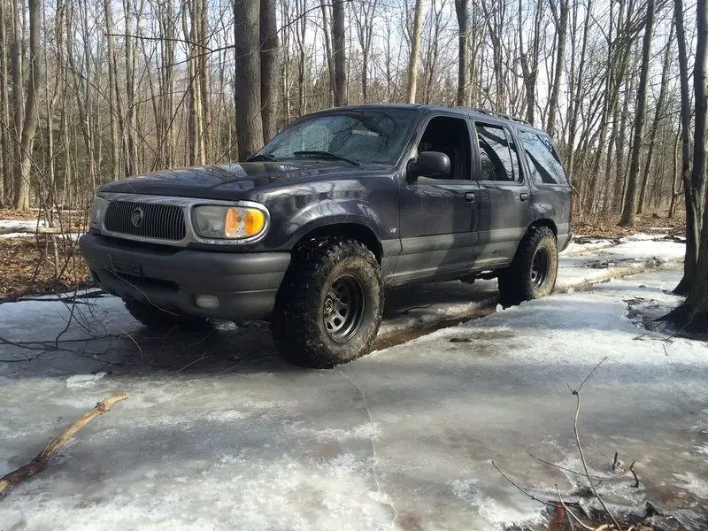

But I did throw some 33x12.5s under it for fun. Didn't end up going wheeling though. Just messed around on the property.
Suspension is still 100% stock. It rubs like crazy but I am not driving it like this or anything. I also did not know the bumper was some kind of polymer. Its not steel.

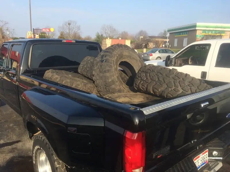

Picked up some tires over the weekend. Took a whole morning of driving around but I wanted them.
They are a little bigger than I was looking for, but challenge accepted.
I got (5) 42x15x17 Pitbull Rockers. No wheels. One tire has some patches which the last owner used as a spare.
All have rock rash but all have great tread.
Hello 4D2s
Previous owners rig. He bought a set of sticky treps to replace the pitts with.

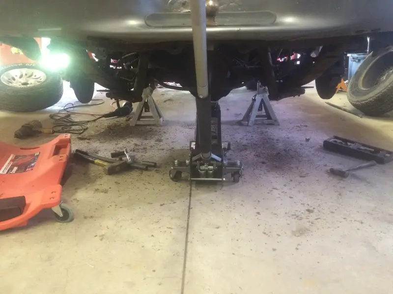

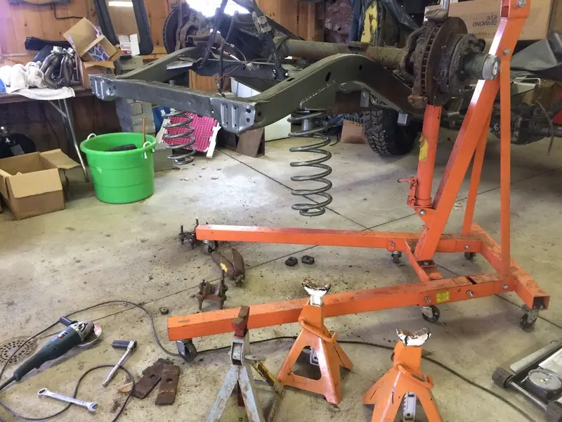

I did technically start tear down on Monday. 5 Months later....

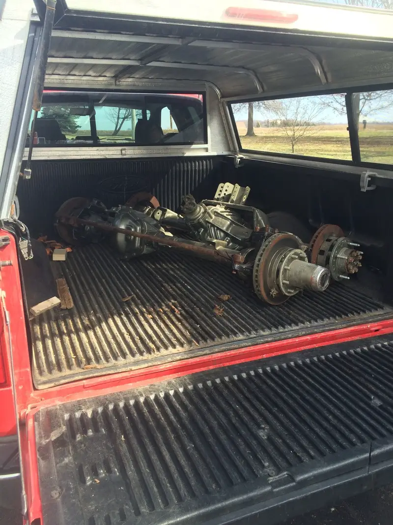

I didn't get far but its a start. I started to pull the 8.8. I sold it to a buddy and he is starting to need it. So I got the upper links, 3rd shock and e-brake cables off. And that was about it... Free time is scarce around here.
I also picked up some wheels. A buddy found a deal on 2008 F-250 17" steelies for $100 with tires and TPS. So he grabbed them for me and got them all in his '91 CRX haha. This is the deal I was waiting for. Some kid offing his OEM wheels cheap for some bro wheels.
They are 17x7.75. My tires are 15 wide but have a lot of sidewall being 42s. With weld on bead locks, I should get near 8.5" wide. I was looking for 17x9s, but for the price of these I couldn't say no. I will get my money back after I sell the sensors and tires.
These 05+ axles require a lot of back space. Especailly if I want to stay relatively narrow. Very few of the "off the shelf" wheels had the back space I wanted. If they did have it, they were not cheap.

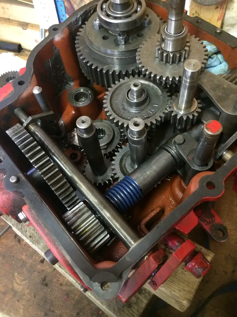

Off topic, but a lot of my free time this spring has been going towards my mower. I mow with a 1974 Gravely and broke a shift fork last fall. My fault. I tried power shifting it. Anyways, I spent a Sunday in January tearing it down. Found the broken fork. Couldn't find a reasonable replacement so I welded it. Its cast iron so I know welding it probably wouldn't hold up. Well, I put it back together in April. Only had 2 gears out of 4 but could shift into 4 gears. Turns out you CAN put a Gravely gearbox together wrong. So I spent a 3rd Sunday pulling it back apart. This time I had drawings. I had a few gears swapped and got it back together. Worked great for 2 weeks then that same shift fork broke. I knew it would happen but was hoping it wouldn't... A few weeks go by and I havnt been able to get to it. My grass is growing fast. So I bit the bullet and bought a new 52" commercial walk behind. Maybe I will lose some LBs.
My old 50" ride on took me 4 hours and 15mins. With this new WB, my new time is 2 hours and 5 minutes. Once I learn how to use this thing, I think I can get it down to 90 minutes. With 2 kids, time is money.
But now I have part of my Sundays open again!
Thing mows like a hoss. This is the first mower I have ever been able to get back to this section of my yard.
Get the whole piece hot with a rose bud, weld it, then bury it in sand so it will cool down very slow and even, and it'll hold. (dry warm silica sand) not backyard dirt.
It's pool filter sand $4.00 for a 90 Lb bag.
Don't know your welding experience, so if you already knew this just insert slap here:
so.. now u got wheels, tires and axles... i am looking forward to this :D
Just need time :thumbsup:
Haha. That is exactly what I did at work. I work in the Steel Industry and specialize in welding overlays :thumbsup:
If it was cast steel it would have worked better. But I am pretty sure it is iron. However, I did do a chemistry check on it. The results were odd.
