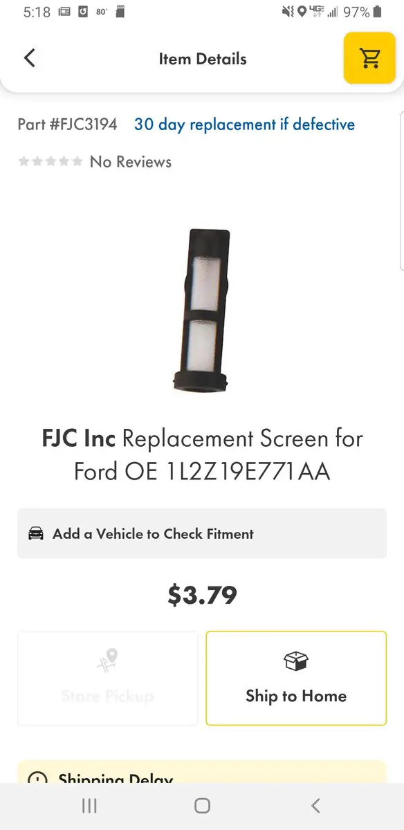

I'm doing a compressor replacement and have a replacement TXV for the rear. The Form tech manual says to replace the TXV inlet filter. Problem is, I can't find a part number for this thing anywhere. Not on Rock, o'Reilly's, Advance, nobody. It doesn't appear to be part of the TXV. Can anyone help me out?
Have you tried a Ford dealer for the number?
