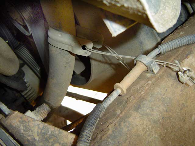

i'll go take a pic of what i did with mine....
This must be a V6 thing. :D
i used one of those pipe brackets that you normall use to secure a pipe against a wall. i just bent it so the two ends were close together. then i just put it around the hose, pulled it away from the belt and tied it off to the frame in a spot where it wouldn't move. i used plain bailing wire as well as some thin cable with a cable clamp to tighten it. i have about 1/2" clearance in there. used something like this rather than simply tying if off because i didn't want to put a kink in the hose and this doesn't do that. its worked so far!!
