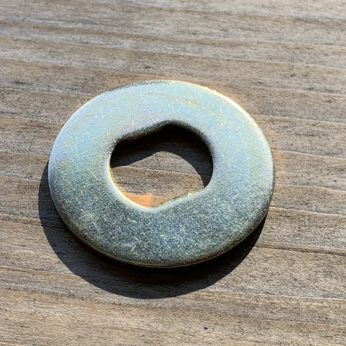

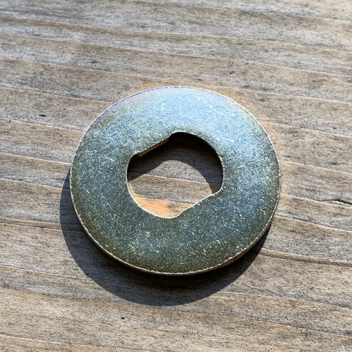

Does the direction of the spindle nut and washer matter? Both have a flat side and a chamfered / rounded side.
I'm thinking chamfered side facing outwards? So 'B' side of the spindle nut facing into the vehicle, and flat / sharp edges of the washer facing in as well?

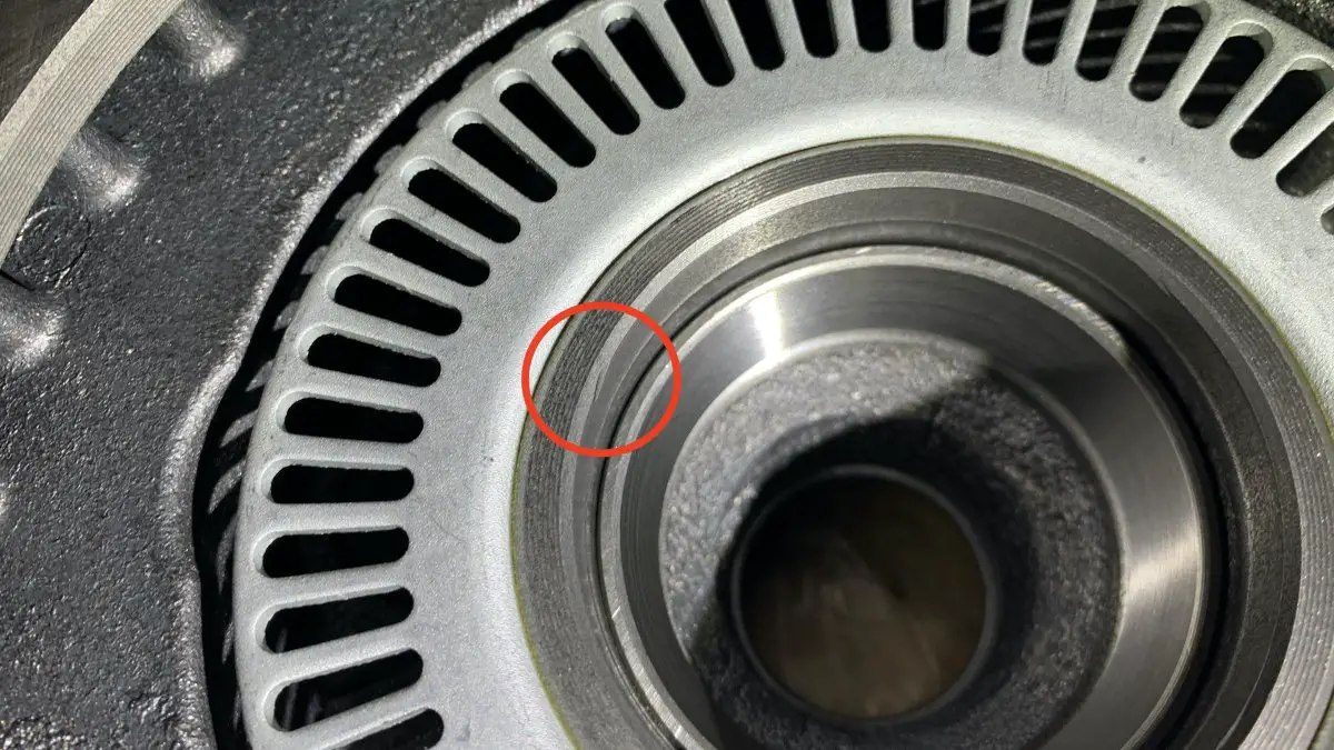

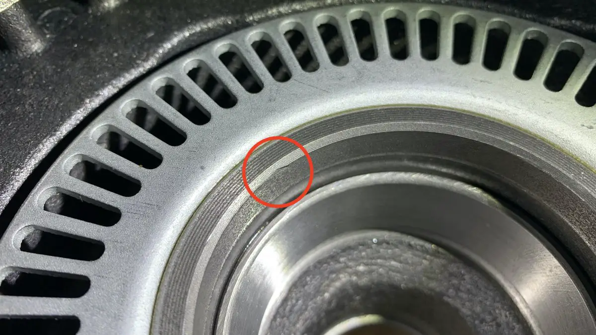

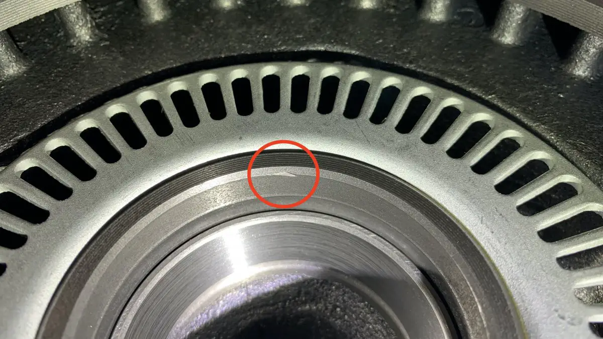

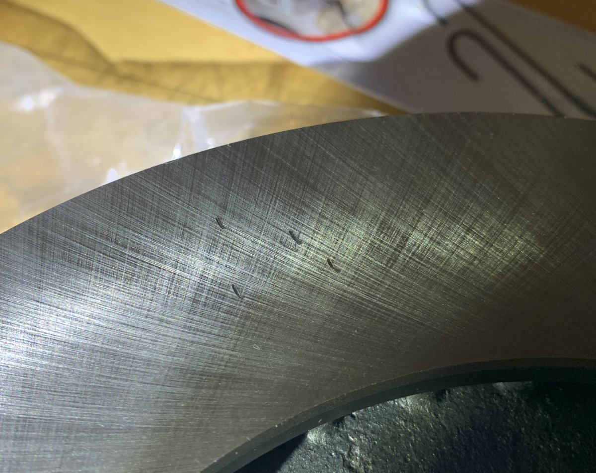

There are a few marks on the rotors I received. There are a few tiny spec-like dents on the surface of one. I figure these won't cause any issues but I'd like to know if they will - I'll request a replacement if so.

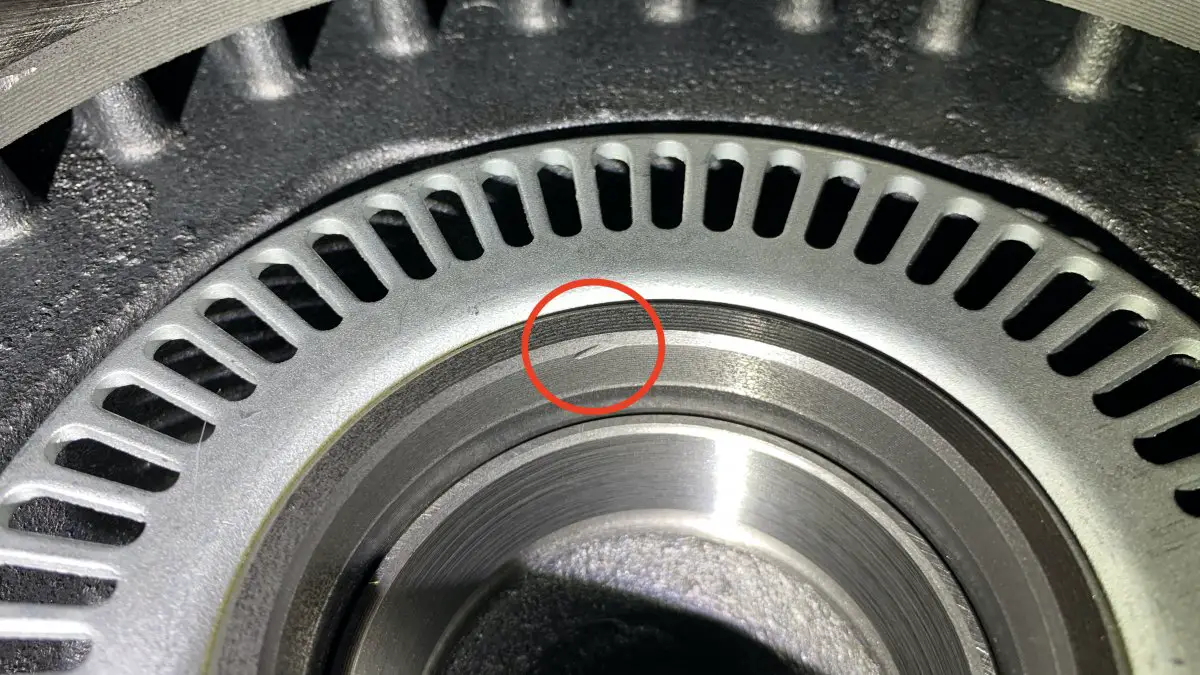

On the inside bore there are a couple of nicks where the wheel seal will go - circled in red. Again, they look inconsequential but I don't know how fussy the inner seal will be. Not sure what level of 'precision' these things need - if that makes sense. I'm not thinking a lot since it gets hammered into place, but perhaps if it's not perfectly smooth the grease could leak out over time?
None of those Knicks will
Matter the seal will hold grease in fine
The brake pad will glide right over those other marks on the surface of the rotor. I do not see a problem
Make sure you clean the oil off the rotor before you put the caliper on
A side out, b side towards the washer

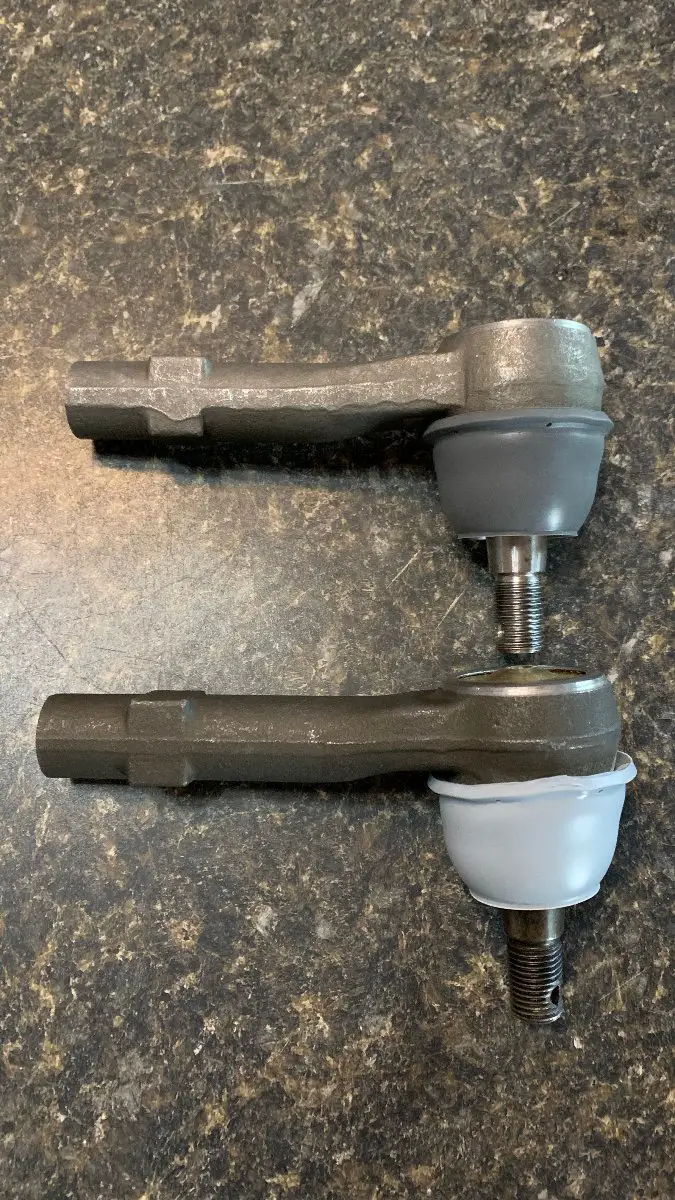

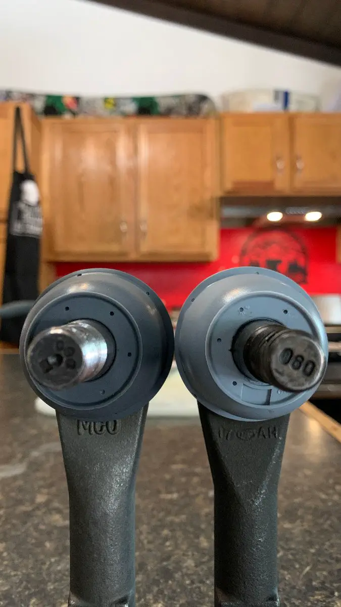

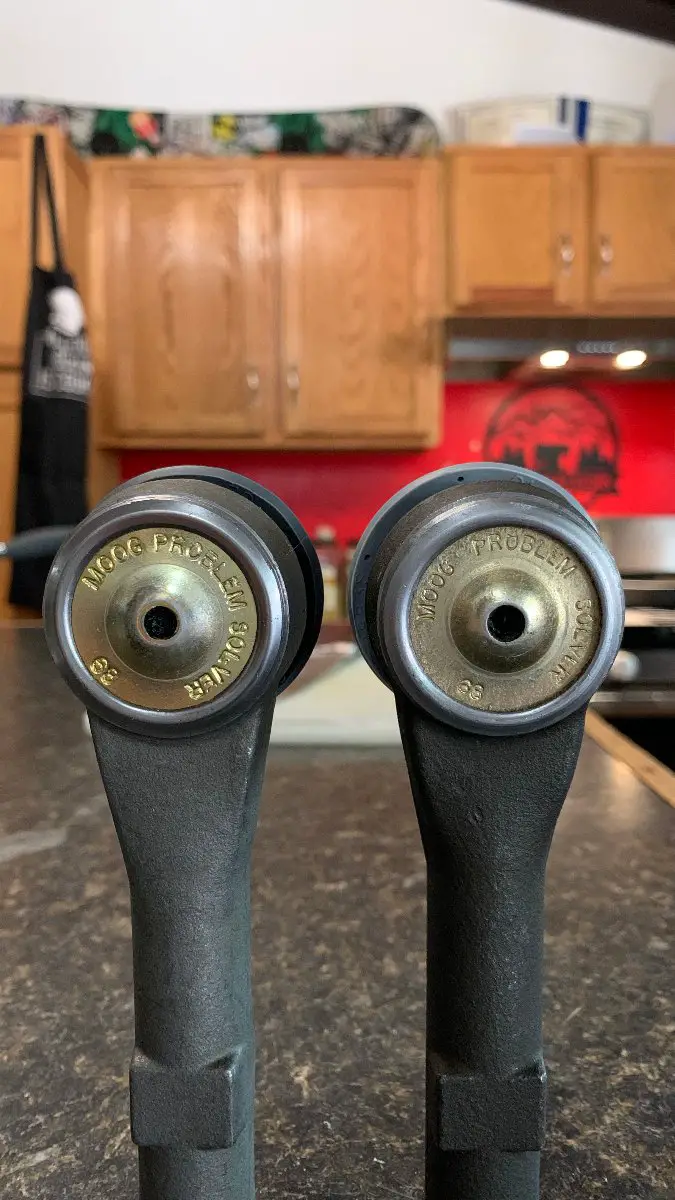

Just got a chance to properly look over the parts I got from Rock Auto nearly 6 weeks ago.
I checked for movement and feel on every ball joint I received, 6 total (2 lower, 2 upper and outer tie rods).
All of them feel much the same - stiff and firm but smooth - apart from one which is one of the Moog outer tie rods.
It is a little more stiff than the others (no big deal) but instead of moving smoothly it feels rough and gritty and actually makes a bit of a soft grinding noise.
They have not been greased yet, other than what they came with from factory, and in both I can see evidence of factory greasing in the zerk holes.
Is this rough / grinding feeling normal when they haven't been fully greased? Or do I need to get a replacement part?
They also look a little different - don't know if that's meaningful. The rough one is the one with the darker grey dust boot.

1. They need too be grease. That will fill in any clearance gsps.
2. I really never compare parts. Old versus new. As long it fit and its the right for the vehicle. Appearance is the same.
Different manufacturer make different parts in dimensions.
there is some lead way, its not extra. The inner arm are threaded.
The alignment tech, will bring it into spec.

I'll pump a little grease in and see if it feels any better. I wanted to avoid doing that in case it makes a mess when installing. I want to be sure it's able to move without grinding before I install it.
So the pictures are of both new parts that I received. The old parts are still on the truck - haven't started yet.
I suppose it doesn't matter. Could be different production runs or from different factories etc.
Don't add grease too you are done with the installation!
