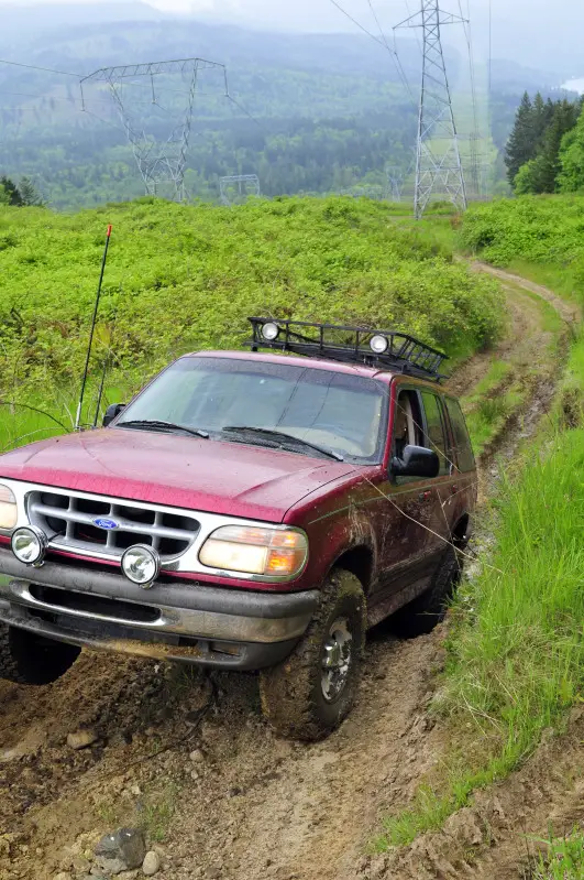

I'll try to remember to post a photo of the suspension flexed out & one of the wheels about 2 feet off the ground and the truck as a whole in a rut almost as tall as the truck itself (getting out was interesting).

here's a couple shots:
