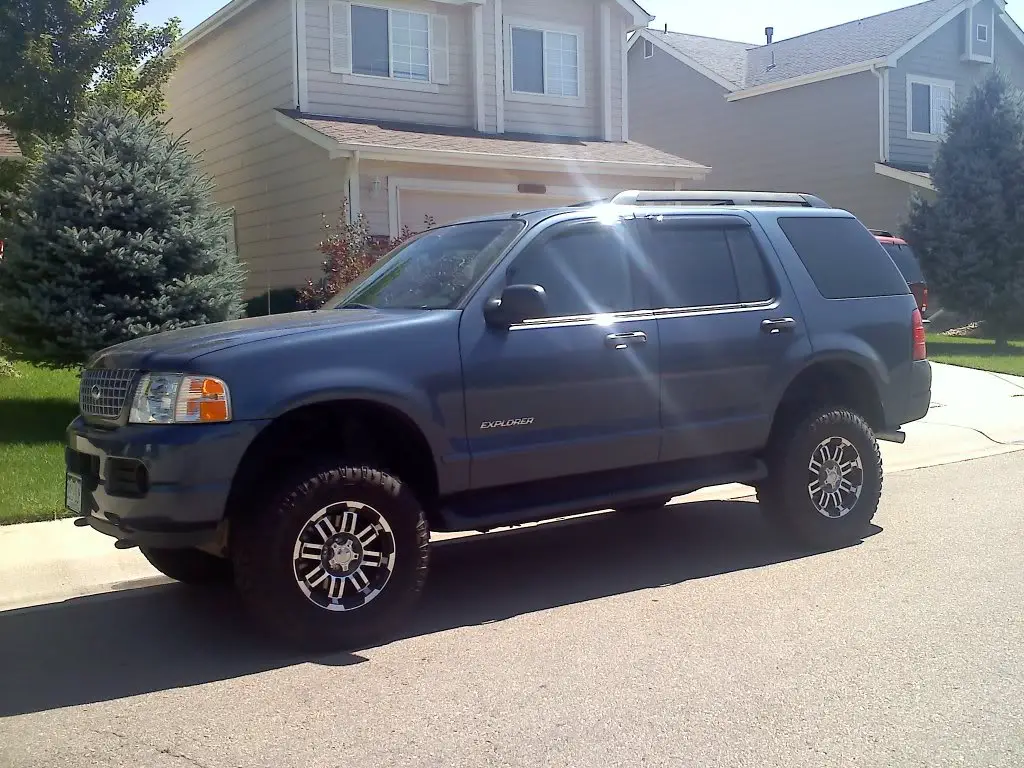

3" body and 2.5" Truxx strut spacers

That spacer lift is the TRUXX spacer lift. It will fit 02 - 05, but the kit requires modification (voiding the truxx warranty).
I highly reccomend you look here http://www.explorerforum.com/forums/showthread.php?t=279667 at BTF Fabrication spacers. Quality product, they're cheaper than the TRUXX kit, and a direct fit on you 2005.
You can use a ranger lift kit is you want a Body lift. It's not a direct fit, you havta get a little creative here and there to make it work out...

The installation of the strut spacers wasnt bad at all. Ive done everything, including strut spacer and body lift, out of my 2 car garage.
