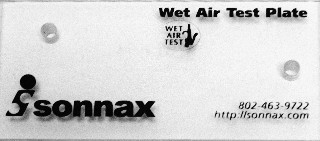

Sonnax makes a valve body test plate for testing individual sections of the valve body if you want to troubleshoot: http://www.transmissionpartsusa.com/WET_DRY_Air_Test_plate_p/400-000swatp1.htm
Sonnax has a free valve body training video on a DVD which explains how to use one of these test plates: http://www.transmissionpartsusa.com/DVD_07_Sonnax_valve_body_traning_video_p/400-00vbdvd07.htm
