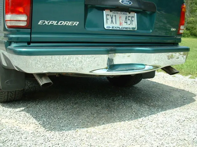

I think you could stick with 2 1/4" pipes. After all, you will still have the single pipe going into the muffler. On my SOHC I have two pipes going into the muffler and 2 coming out that are both 2 1/4"...
