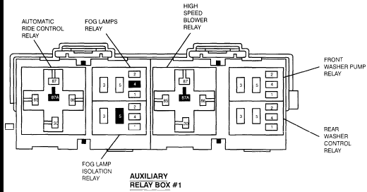

DW
You will find the relay box under the air air intake tube on passenger side.

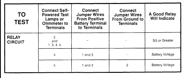

Never really messed around with relays before, is there a way to tell if they are bad? or just replace it?
Take a look at this .....
