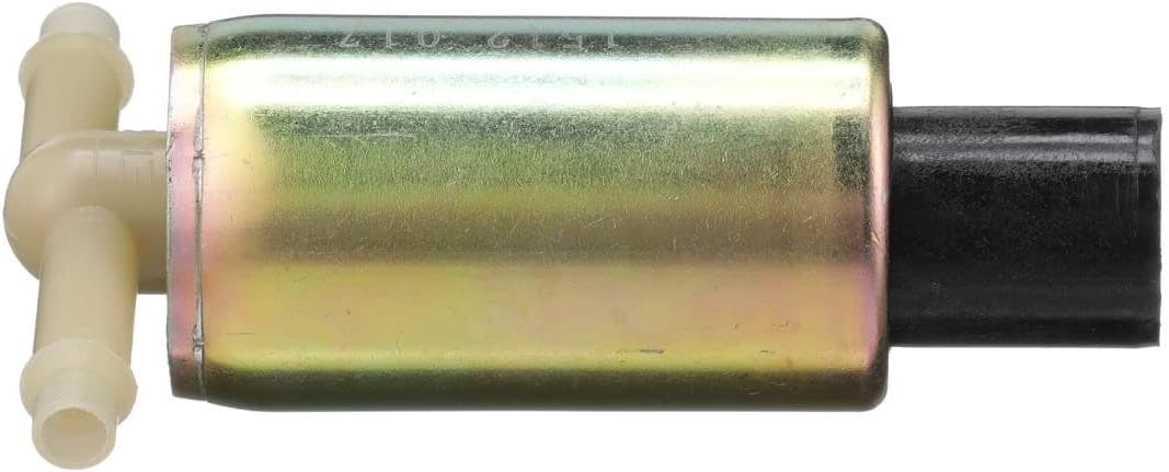

Not sure how I can get my hand on the solenoid and connectors
Do you ask about this oh-so-inconveniently-placed component?:

Yes, that is the suspect! After last months major tear-apart to replace failed engine gasket, I can actually see this solenoid a little better than before, BUT it is still up under the ?plenum? and I don't see how I can get my hands on it to disconnect/reconnect its hoses and cables.
I smell fuel strongly after about 15 minutes of operation I'm guessing solenoid or wiring or tubing suffered trauma during the big surgery.?? Bleeding hiss/pressurized fumes from gas cap every so often keeps the fuel smell out of the cabin. --the excessive gas cap hissing/decompressing of fumes makes me think the solenoid is not sending fumes to the charcoal and fumes are getting out of the system anywhere they can. ???? Still diagnosing.
