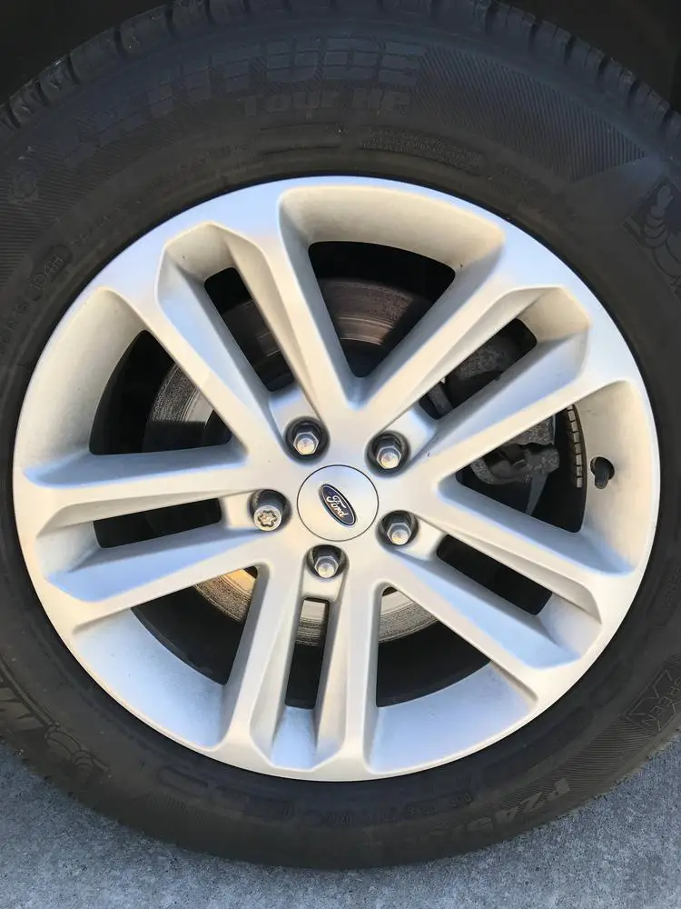

That seems out of the ordinary. My 14 with 62,000 miles has been fine with a once a year clean up. Last weekend I did my annual inspection. Pads are good, I pulled the eight clips and I use a Dremel with a brush attachment to clean up the bracket. Do the same to the clips to remove gunk / dust that pretty much covers them. Then I use a thin coat of silicone caliper grease on the bracket as well as on the clips. This is a pretty severe application as we spend the winter in the mountains that on average receives 550" of snow. Every day all winter we drive down one of the steepest roads in the U.S. which can definitely over heat the brakes and I have not had any issues. That picture would sure seem to indicate a bad caliper or frozen slide pins at a minimum.
That is Normally my routine as well. Tore them down again last night, and since I have done them so many times, the last time the clips were still in like new condition, so I must have just wiped them down and lubed them. Turns out there was quite a bit of corrosion underneath, so I did the grinder clean up and put some new clips on. 150 Kim’s travelled so far today, seems all is good. Also, what you put on for mileage in 4 years, I do basically that amount each year.
