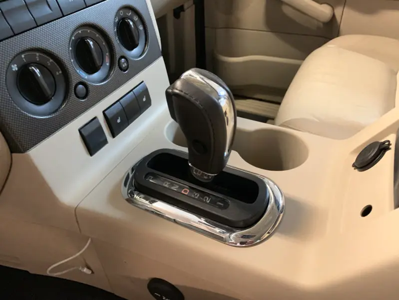

I wonder if something got messed up with the little white box that the O/D wire plugs into. While I have read plenty of people having an issue with this preventing them from shifting at all, I wonder if in my case it is making shifting without pressing the brake pedal. Need to find time to get into this again. At least that part is cheap... https://www.amazon.com/Dorman-924-707-Shift-Interlock-Module/dp/B009AAEK3Y
Having a hard time finding the little pin though and plastic plunger incase I tear mine up removing it. I can find the pin for a Ranger, Explorer Sport Trac but only for earlier years. Anyone have the part numbers for the pin and plastic plunger? If they are cheap I am considering just grabbing them and if I don't need them can just return them. But want them on hand in case I tear mine up removing it.
