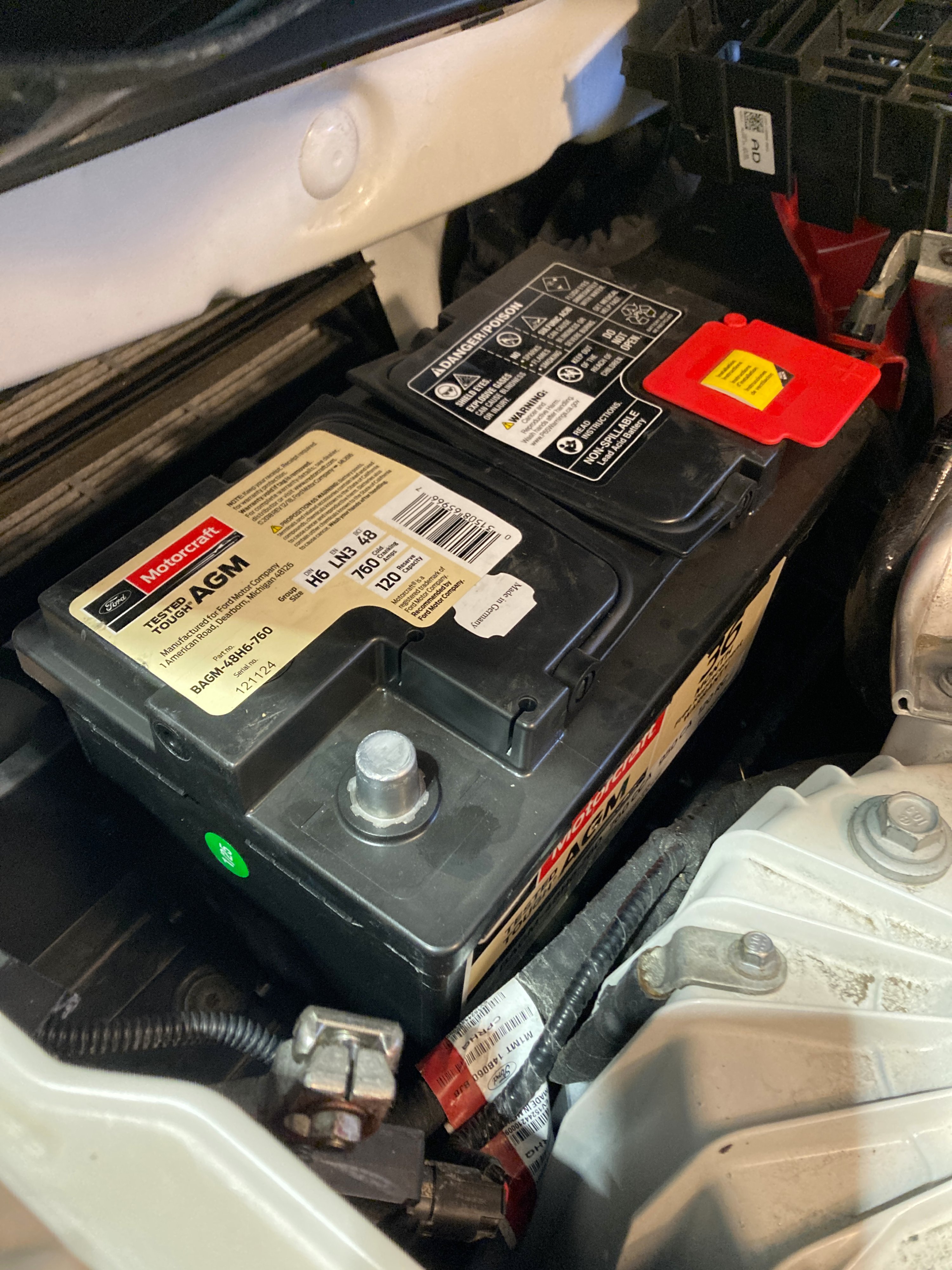

On March 31st 2025 the OEM battery needed replacing. That's right at 30,000 miles and 42 months.
Purchased the recommended replacement at a local FORD dealership.

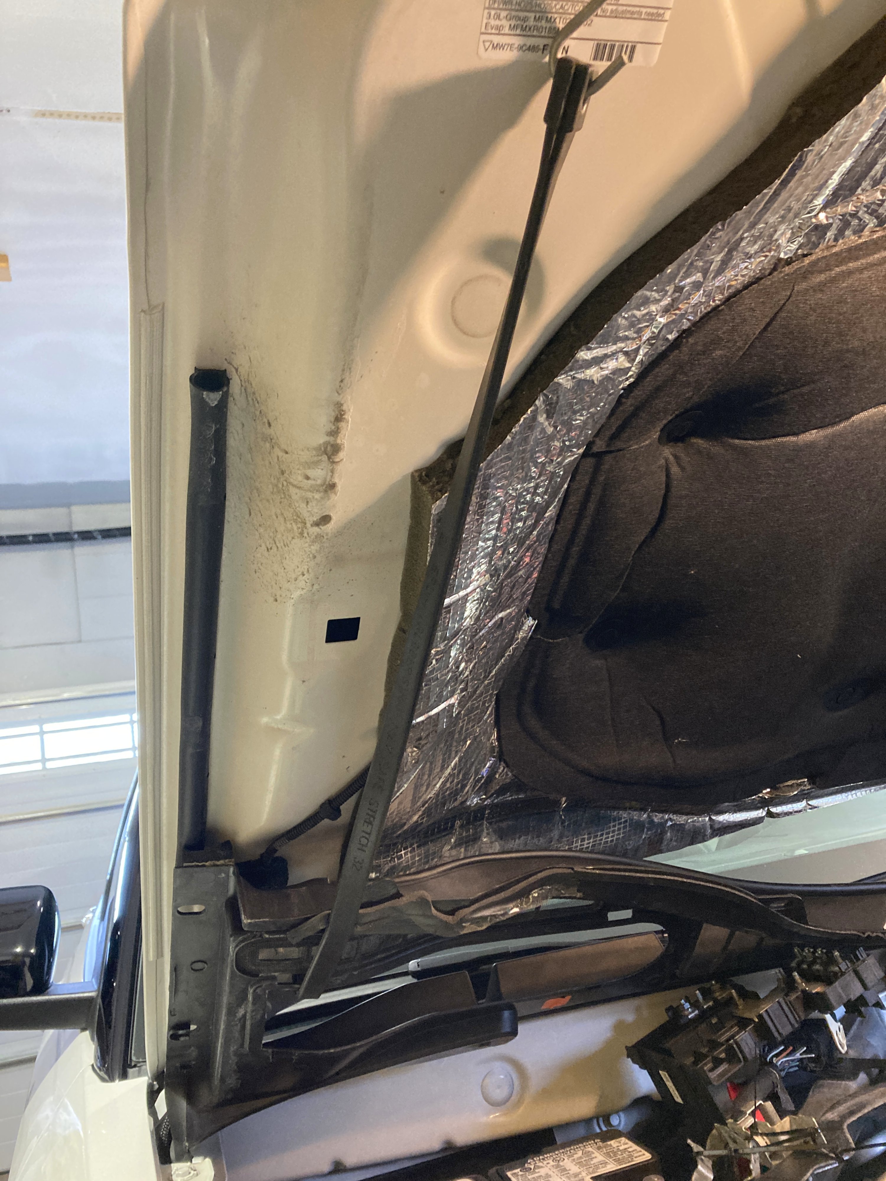

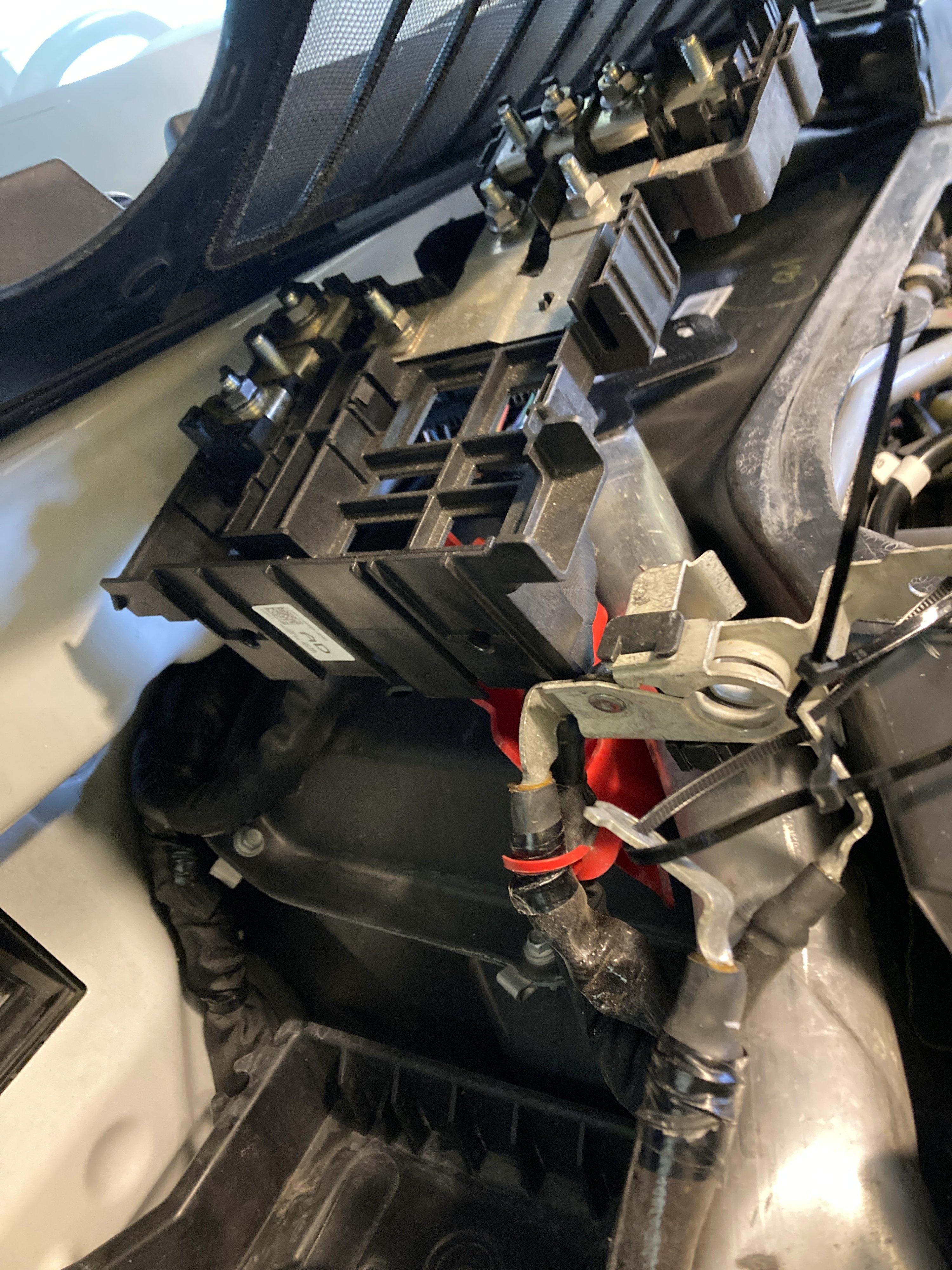

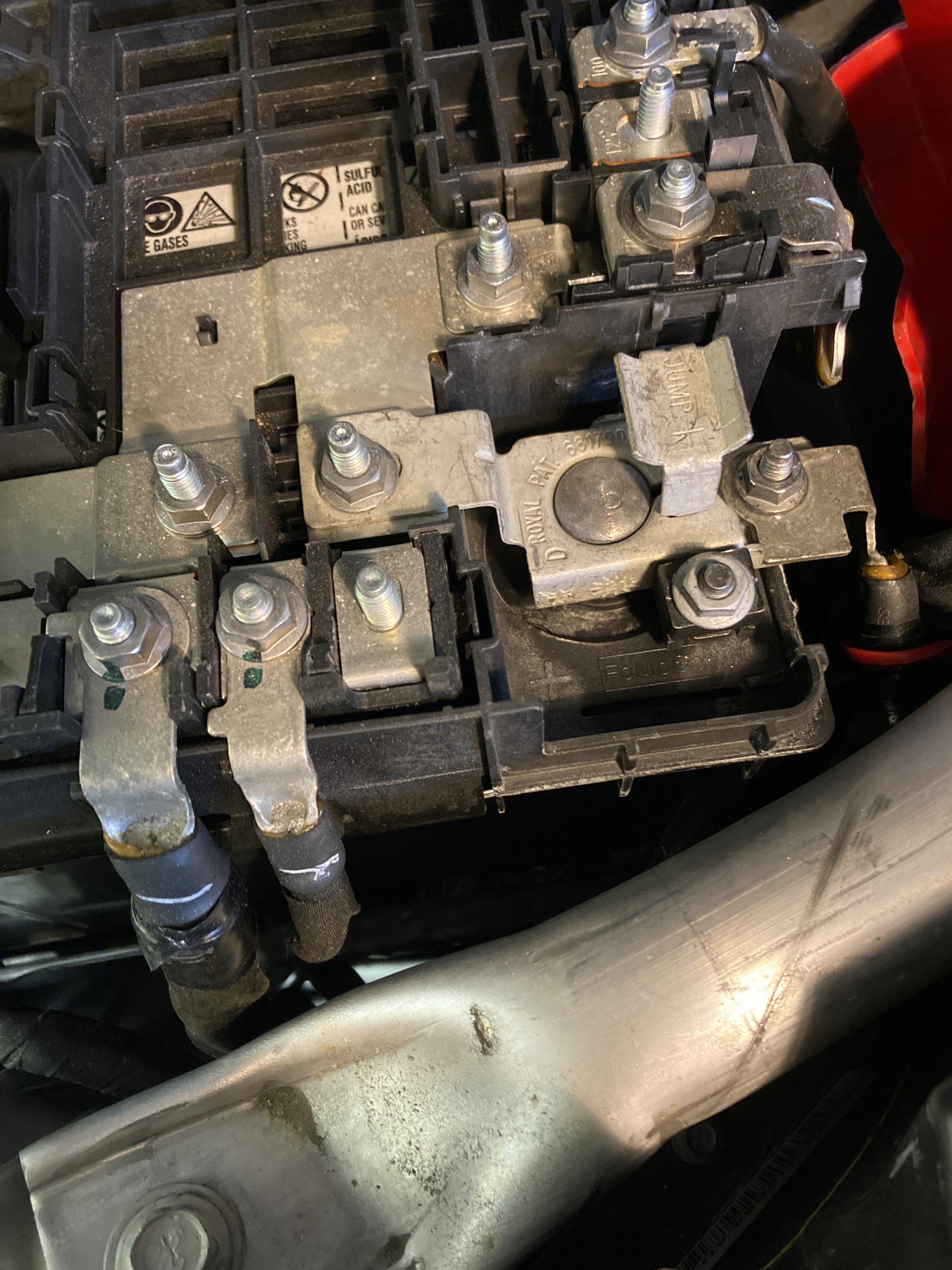

Disconnected a few of the wires from the positive terminal distribution block and that made it much easier to remove the old battery and reinstall the new one. Cable ties kept the cables clear of the battery.
A rubber tie down strap held the black plastic cowl cover up and out of the way.
Reset the BMS afterwards too. Notice the Made In Germany sticker.

View attachment 463563 View attachment 463564
View attachment 463565 View attachment 463566
