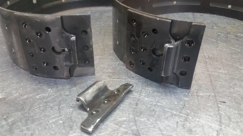

Hello everyone,
Long story short, was having lag issues shifting between 2nd and 3rd unless i feathered the throttle. Was getting a PO745 in the scanner (solenoid pack). Took the pan off to replace the solenoid and found this guy on the magnet. Looks to be in good condition. Its something related to the intermittent brake system. Can someone help me out on what it is and if its fixable?
I have a 2002 Explorer XLT V6 with a 5R55S I believe.

You have a non-operating band. The part is the link which connects to the band and compresses it. This likely indicates the band has broken, IMO. If 2nd. gear operated normally, no noises or slipping (engine speed-up), and 3rd. gear felt abnormal, I'm fairly confident the Intermediate band is at fault. It is the only band applied in 3rd. gear. imp
That for sure is a band anchor and now one of the bands doesn't work. You have to tear down the transmission to fix it.

You have a broken band that will require transmission removal and disassembled for repair. Very common issue along with others on this transmission. Best of luck.
