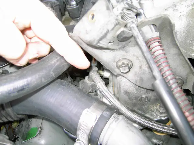

Maybe not necessary, but picture showing location of FPR on the 4.0 OHV.

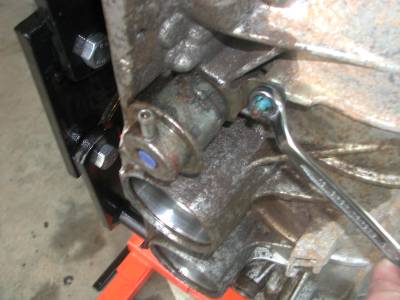

The modulator is located on the passenger's side of the transmission to the rear of the servo covers. It has a vacuum line connected to it. Pull it off, and check for ATF. Just be careful not to lose the small pin inside of the modulator when you pull it off.
Transmission Module Replacement

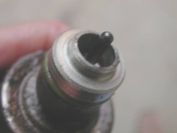

Replaced the Transmission Module today...and let me tell you, that is no fun job! Initially, I pulled back the carpet and removed the access plate and was going to do the replacement with that route, but it was suck a tight squeeze. I then wanted to go from underneath; remove the cat and heat shield, but the bolts on the cat were rusted and seized.
So I went through the access plate, which by the way, barely gives you enough room to get a wrench in there, let alone your own freakin' hand. I don't recommend this, as I am sure there are more convenient tools to use, but I took my hack saw and made the access plate bigger, haha.
Glaciers advice was helpful in stepping me through this replacement job.
The nuts finally came off and the modulator popped out. Getting the modulator back in took little effort, and greasing the end of it was too thank for that.
Transmission isn't slipping anymore, and my CEL isn't on all the time anymore, but frequently illuminated from time to time. Next is replacing the Fuel Pressure Regulator. Any detailed step through of this procedure so that I don't mess anything up and/or catch myself on fire. Photos are always a help.
Thanks again to Glacier for his transmission intellect.

To change the FPR:
First relieve the fuel pressure. Pull back the top of the passenger carpet and disconnect the connector from the inertia switch, the one with the red button on the firewall. Start the engine and let it run till it stops. There are a couple of other methods; do a search for directions.
Removal of the FPR on the OHV is straightforward. See pic above. Unscrew the ful line, and unbolt the two 10mm bolts. Installation is reverse, don't forget to reconnect the inertia switch before starting. Wear eye protection.
