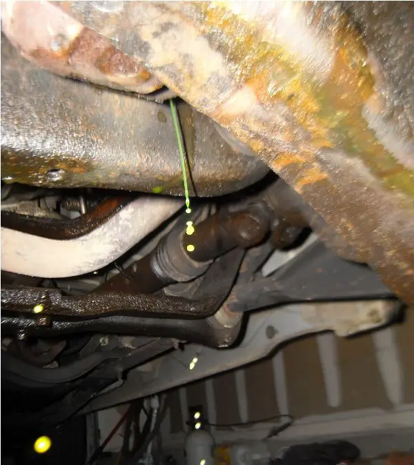

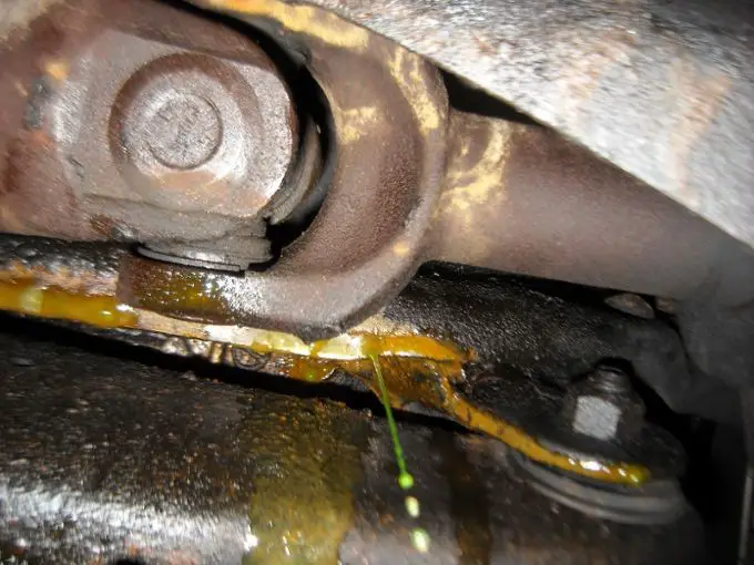

Just for grins I took some pics of the fluid running out of the vehicle. And like I said, this is a cold engine. It's actually dumping a little farther back that what I originally thought.
And while I was taking those pics I felt a drip on my arm. Could definitely see it coming off the Crankshaft, but I could barely see "green"above it at the water pump seal as well.

It does drip from the area of the fan clutch. Water pump (I believe) sits above that so I woud assume the dripping from that area is due to the water pump. But this steady stream comes from a good foot behind that.
You can see in that picture that it's running towards the rear of the vehicle. You really need to spot the leak from up top. Either wet timing cover or wetness on the side of the engine by the frost plugs or between the belt and valve cover.
