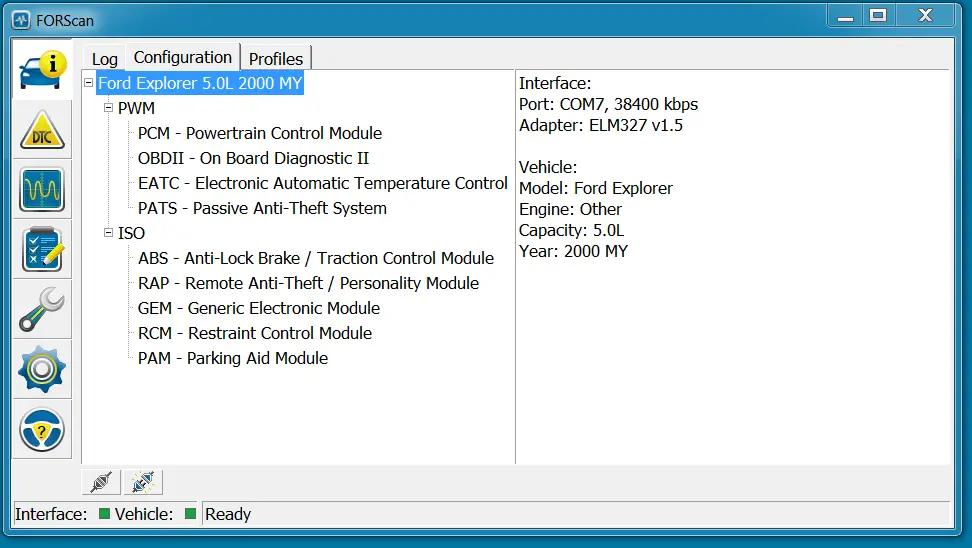

I found this free OBDII software specific for Ford, Mercury, Lincoln, Mazda:
http://forscan.org/
It is amazing, reads nomal PID's, PATS, ABS, ETAC, CAN bus... stuff that Torque can only dream to read.
I am using it with a ELM327 mini V1.5 (from eBay) and my laptop with integrated Bluetooth. If your laptop doesn't have BT, there are avail cheap BT-USB dongles.
Awesome, thanks for the heads up. I just downloaded it and tried it out with my cheapo $10 ELM cable from eBay. Looks like I have a couple stored codes that didn't show up with my other OBDII software -
1. B1352 Ignition Key In Circuit Fault
2. B1942 Air Bag Crash Sensor #2 Feed/Return Circuit Failure
I'm pretty sure they are both old, both of those problems were resolved quite a while ago.
Also I tried out the diagnostic tests, it was weird sitting there during the GEM test and having my door locks lock and unlock, window roll down, and lights go on and off all by themselves.
Anyways cool software and it's free!

Those GEM codes don't trigger CEL, they are not read by usual OBDII software, so you won't see them unless you go to the dealer.
For me the ABS module is the best, since you can actuate the valves in needed (to air it out).
