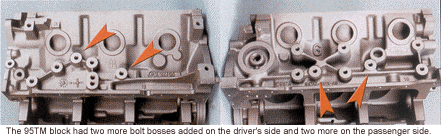

where would the freeze plugs on a 92 4.0L be located?
It looks like there will be six in total. I know there are a lot of stories about this but has anyone ever seen a block crack from being frozen? ignore the arrows the freeze plug holes will be the larger holes above the bolt hole locations in this picture.

Usually there below the exhaust manifold, you should be able to see 3 on each side through the wheel well, there are also one in the rear of the motor behind the flywheel.
It lools like there is one on each head in the rear also...
