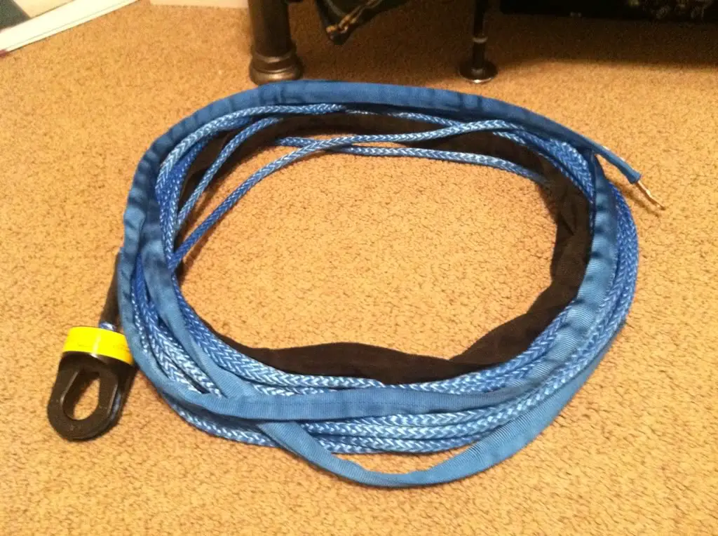

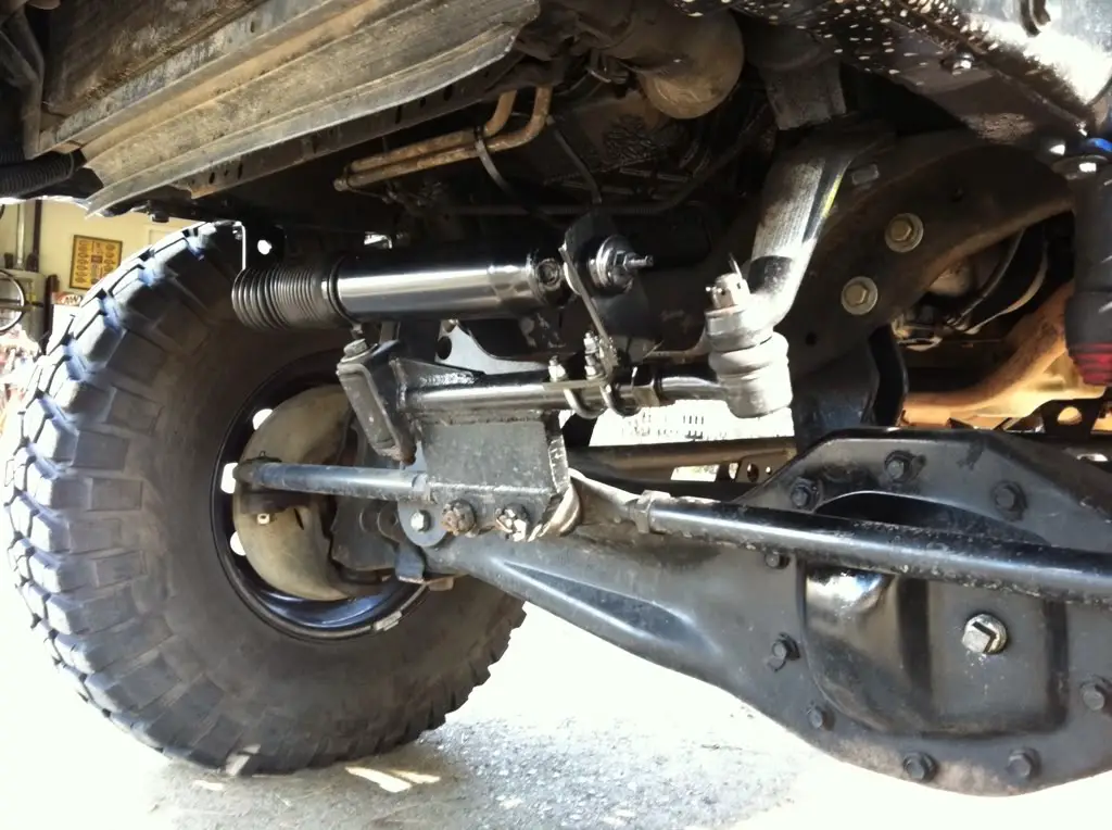

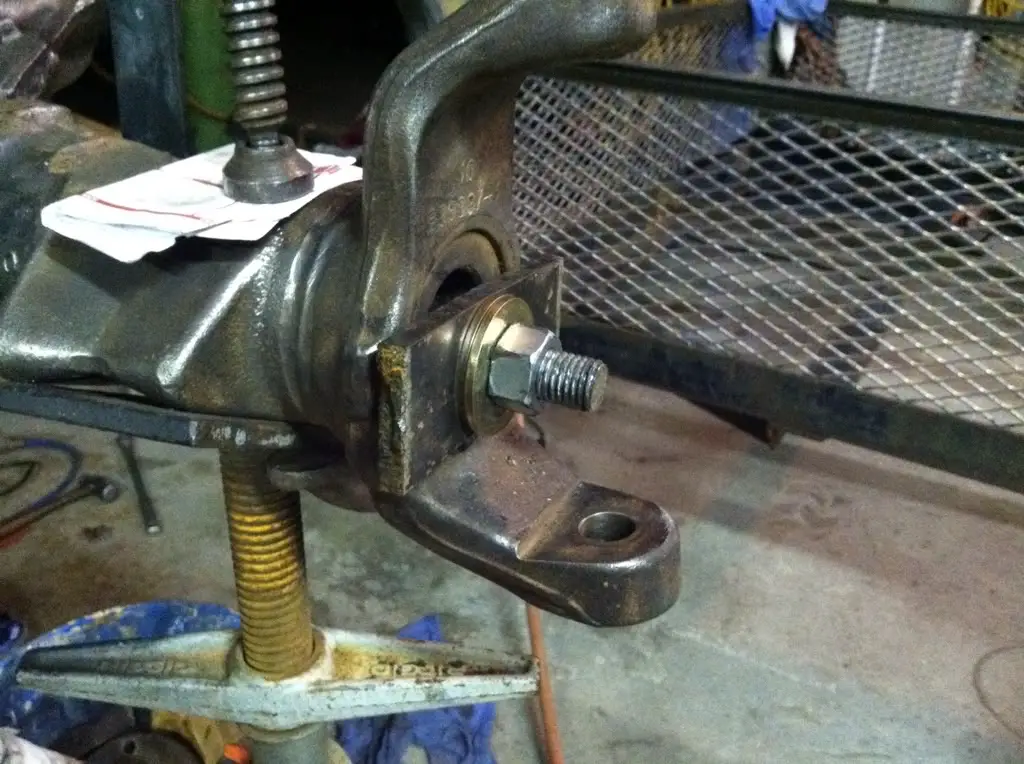

Spiderdtrax offset hawse, 2 black d-loops and isolators & I got the steering damper bracket made and all back together:

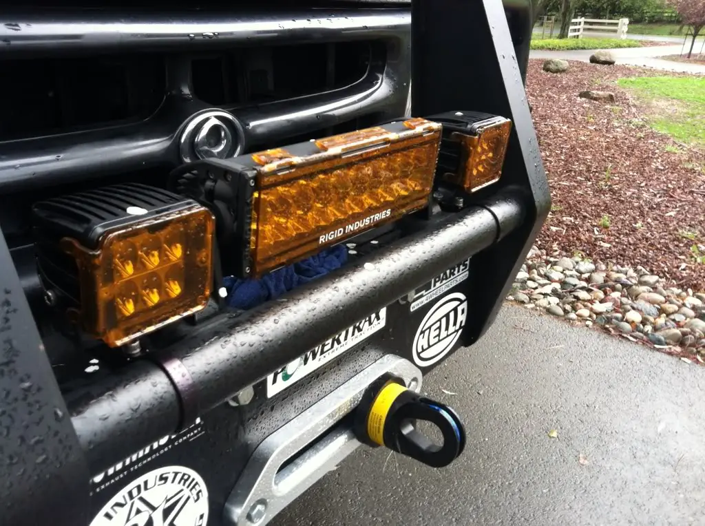

Amber cover for the fog:

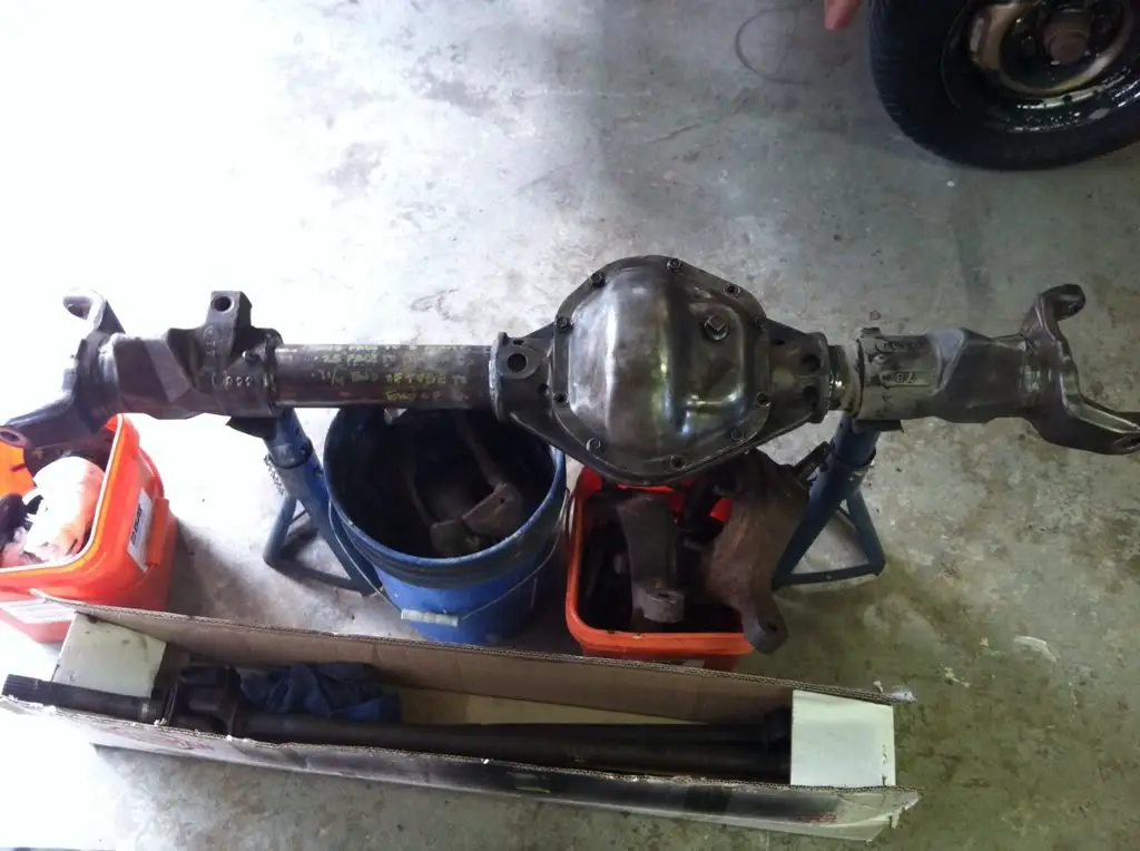

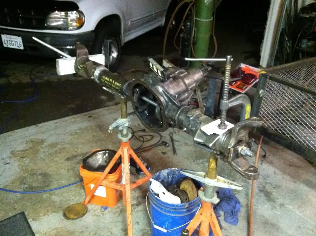

1978 HP D44 out of a F150:

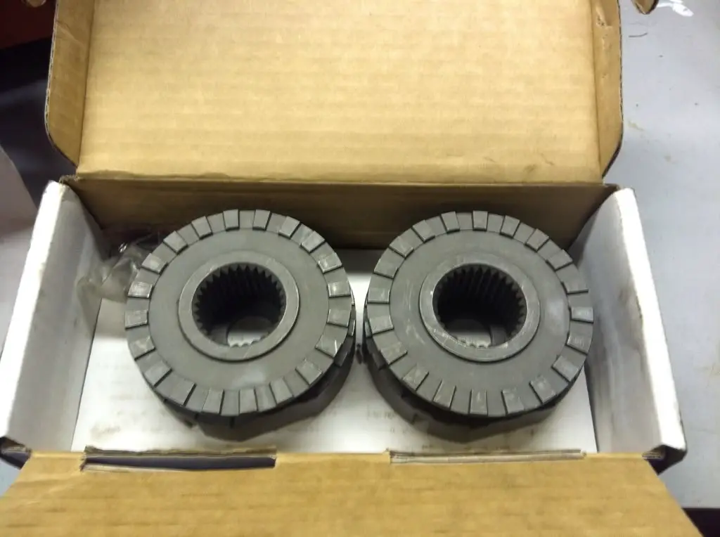

Gonna narrow the D44, run James Duff long arms, mid-steer (considering high-steer), Warn hubs, ARB, 5.13's or 5.38's, and 35" or 37" BFG KM2's :thumbsup: Also considering switching to 6-lug, since the rear axle I will have to have new shafts made anyway.

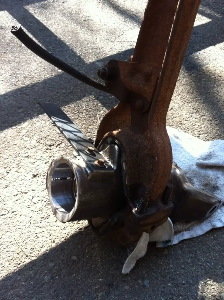

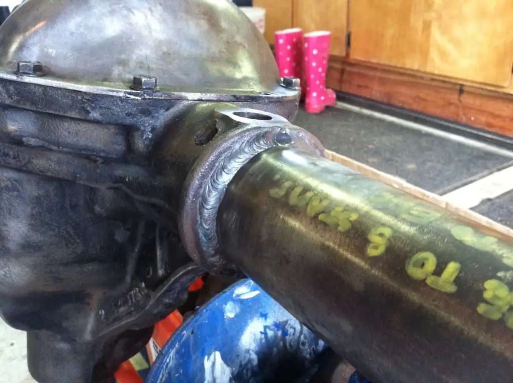

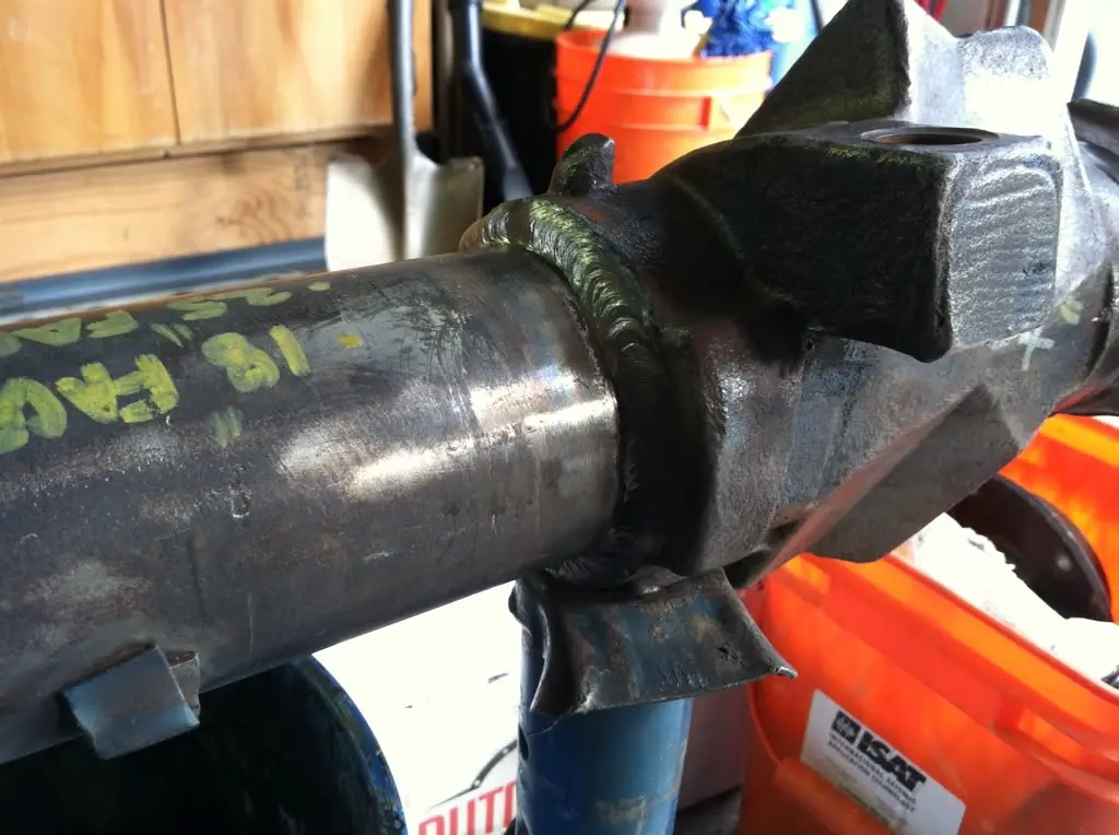

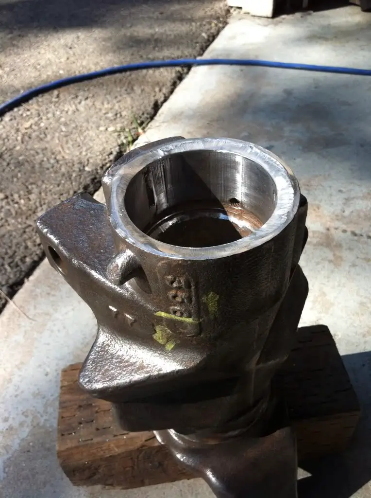

March update. Axle is narrowed and welded up. Bought an Aussie locker for cheap off Craigslist. Gonna bypass the ARB locker for now, too expensive.

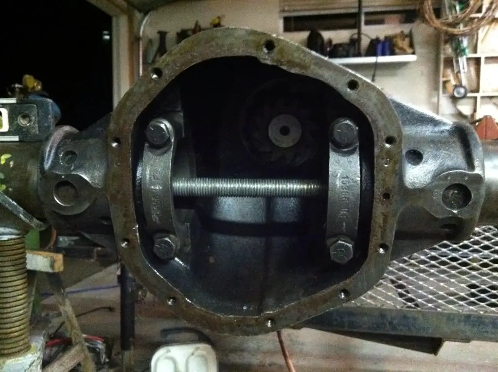

Sucked the wedge back on the axle with 3/4" all thread and an impact. Much easier and faster than other methods I have seen.

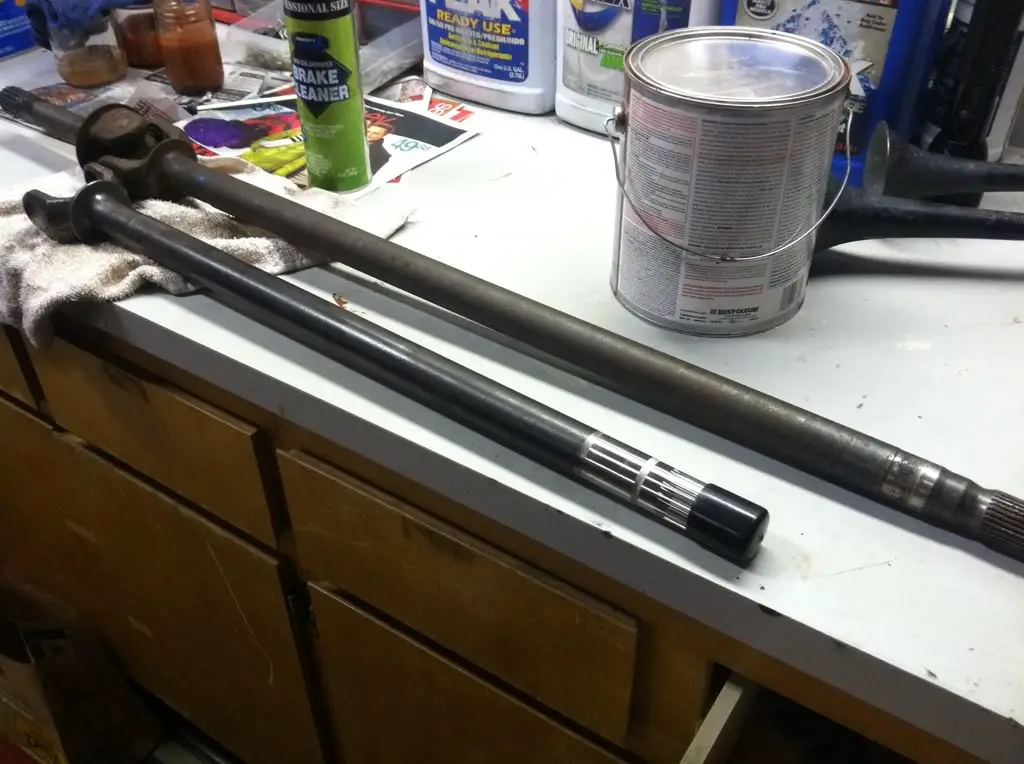

Picked up a shortened passenger side shaft:

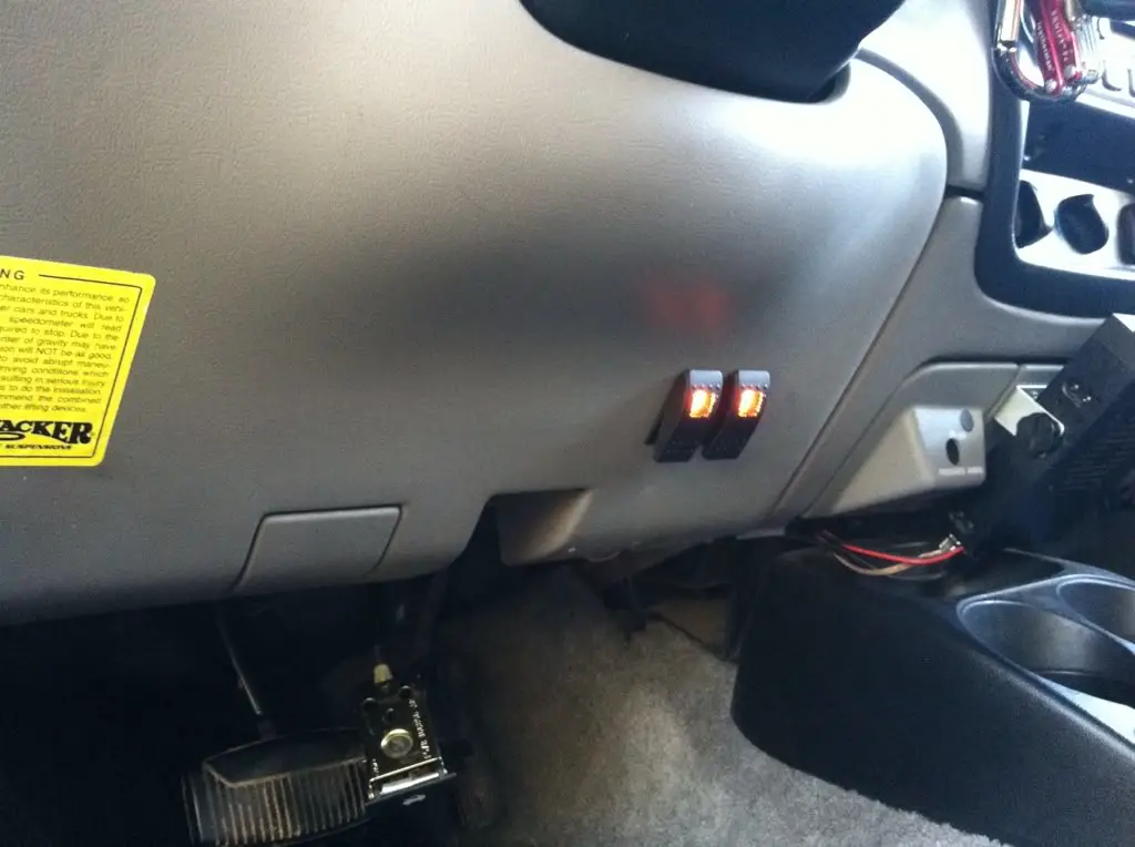

ARB style switches for all my lights:
After:

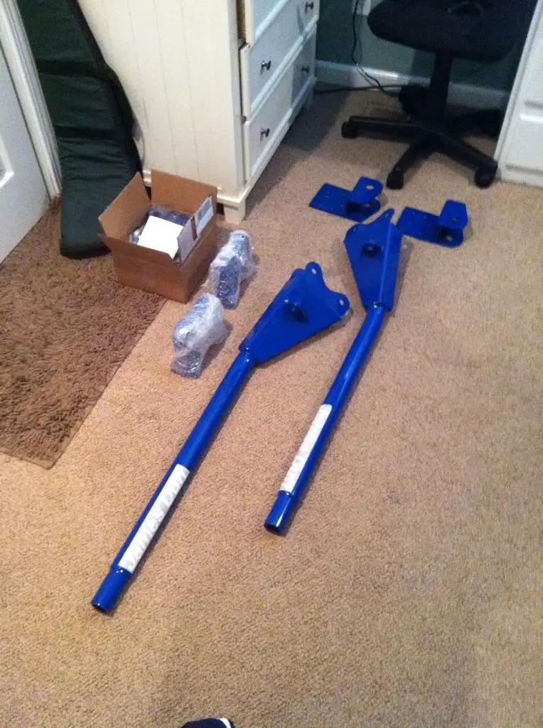

Axle is geared (4.88) and James Duff Long arms in the mail. Will put pics up as soon as they show up... :thumbsup:

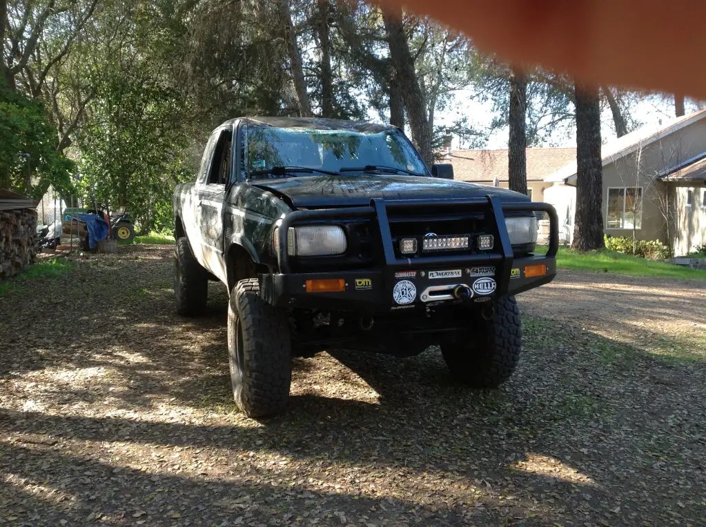

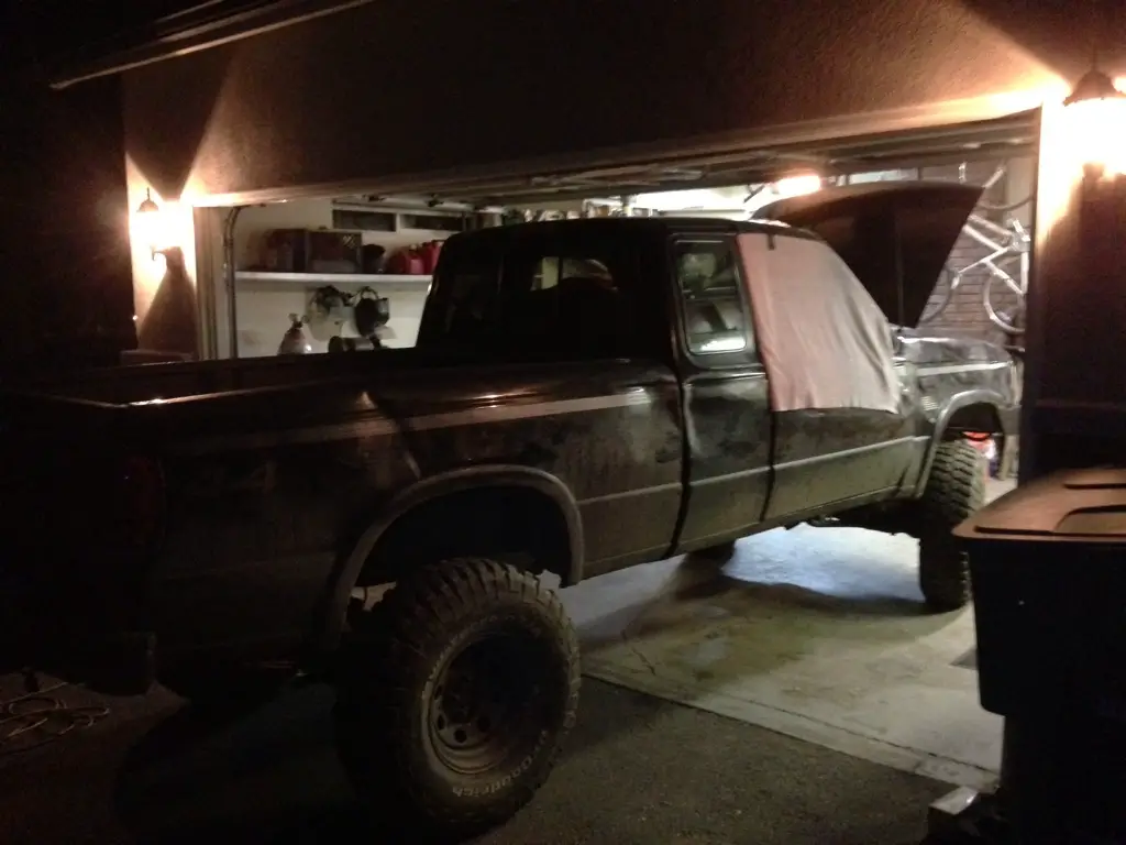

Just got a commuter so might be doing a SAS on this thing in the spring...

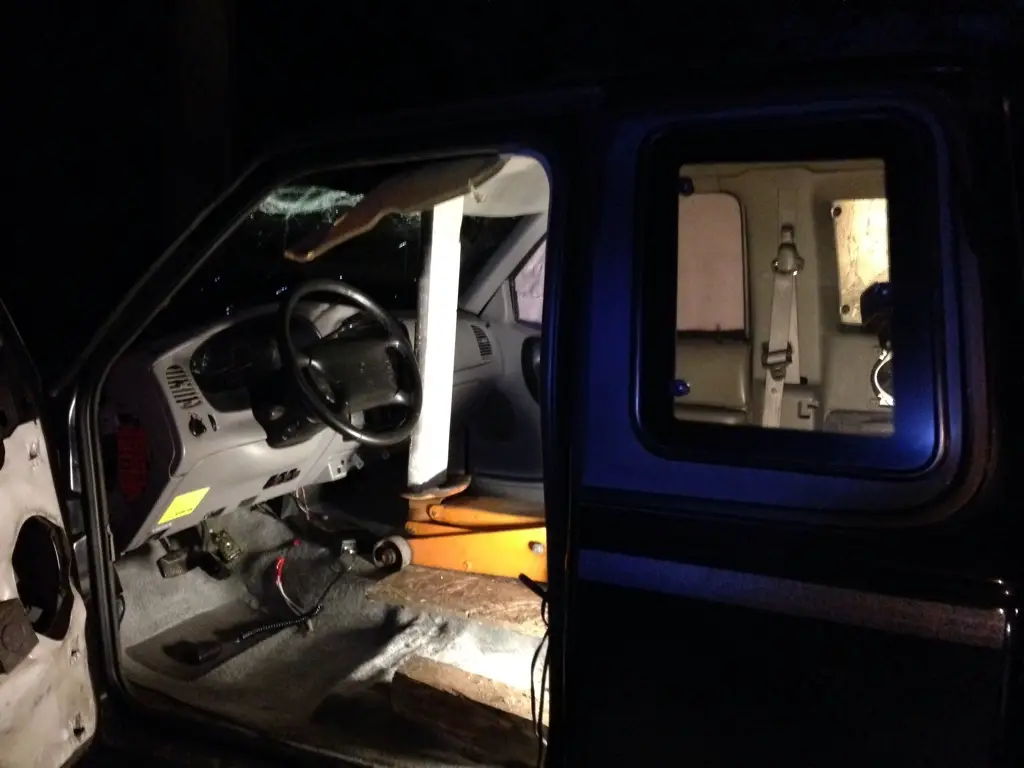

Well, bad news. I rolled the mazda.

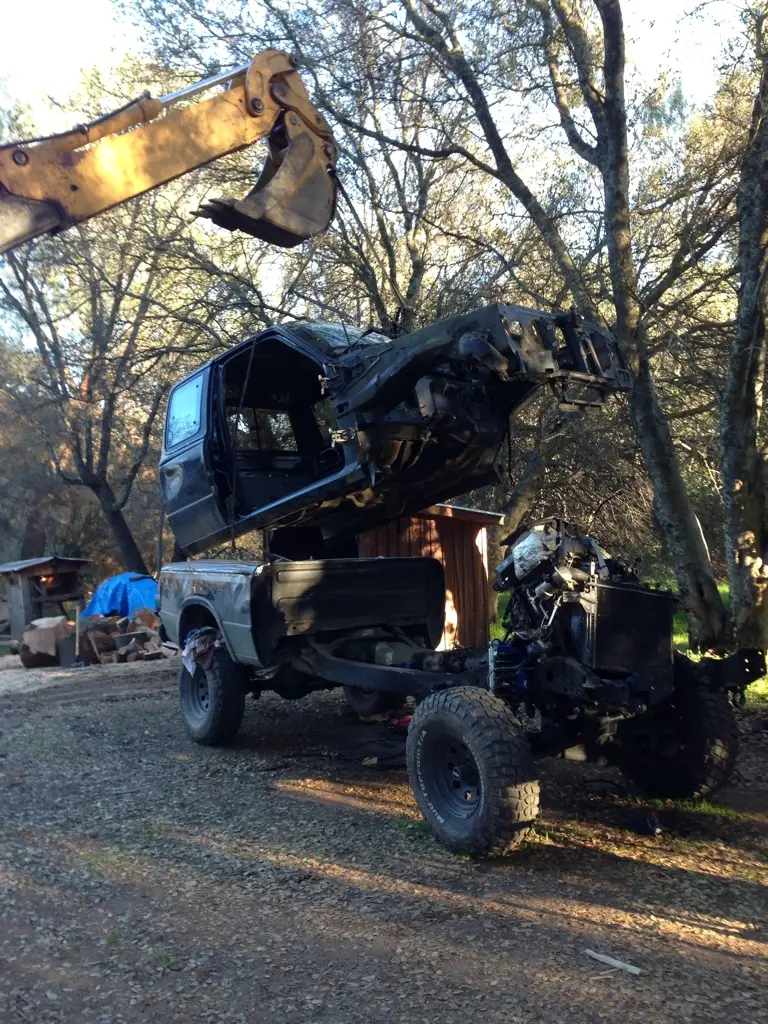

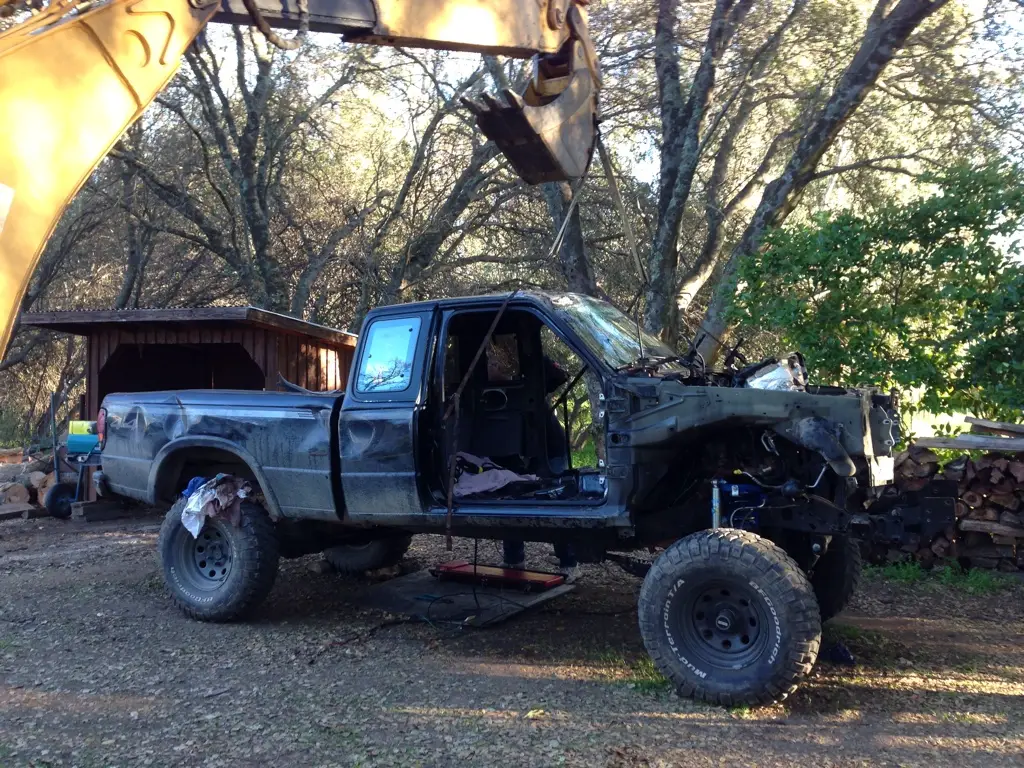

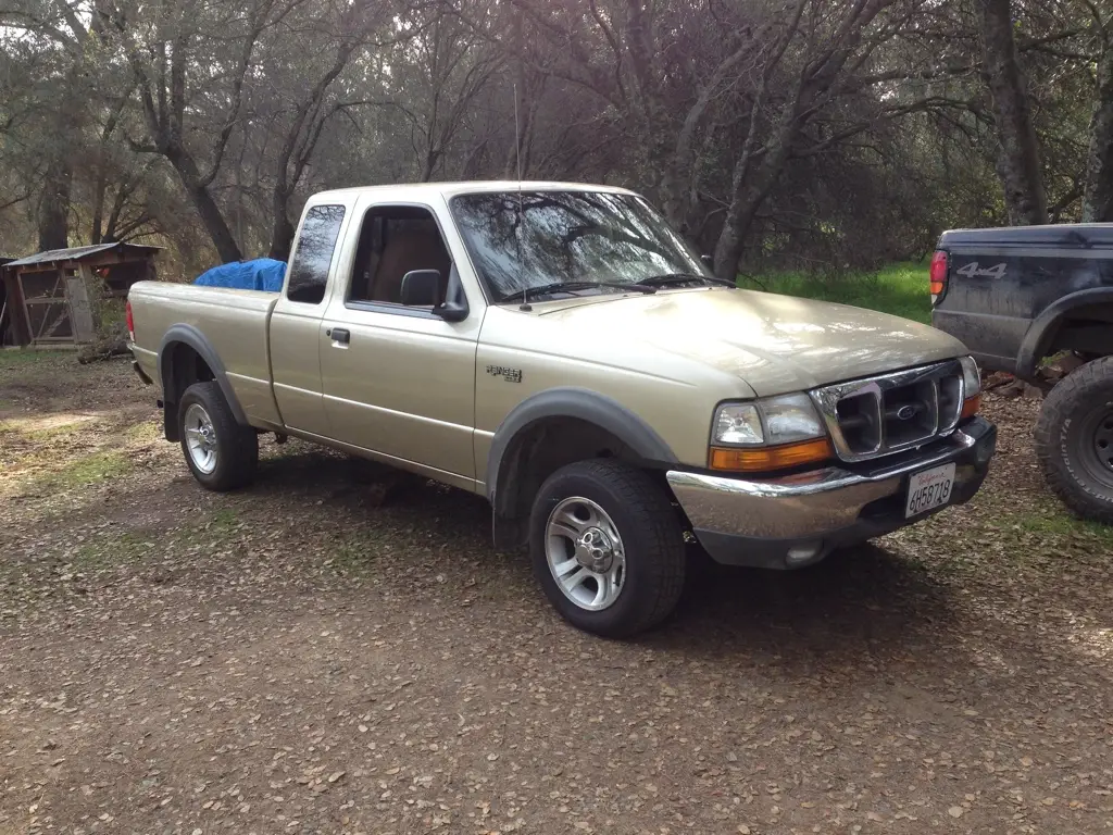

Bought a 2000 Ranger and will be doing a complete cab, computer, dash, and harness swap to put the 2000 cab on the 1996 frame. Just can't bear to let her go :D

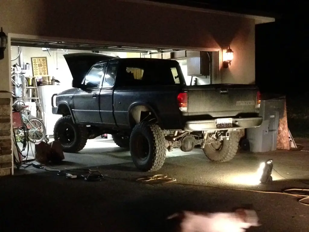

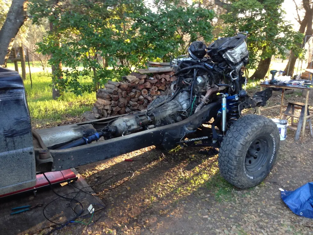

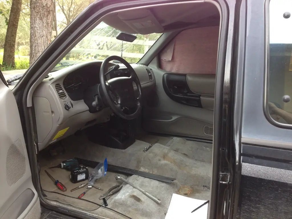

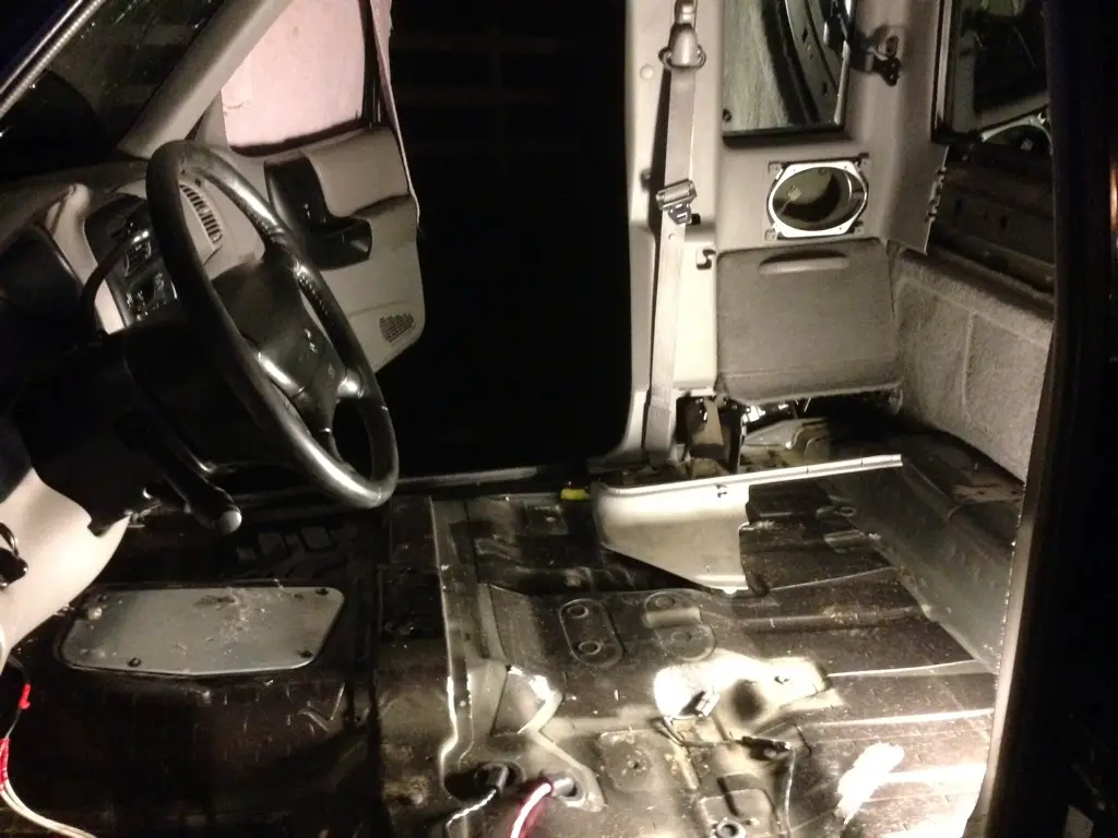

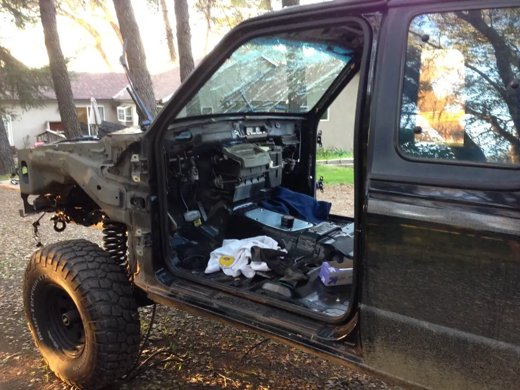

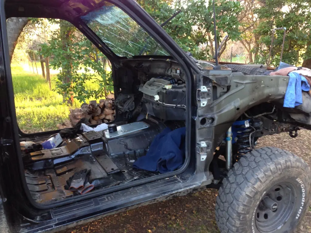

Got a lot done this weekend:

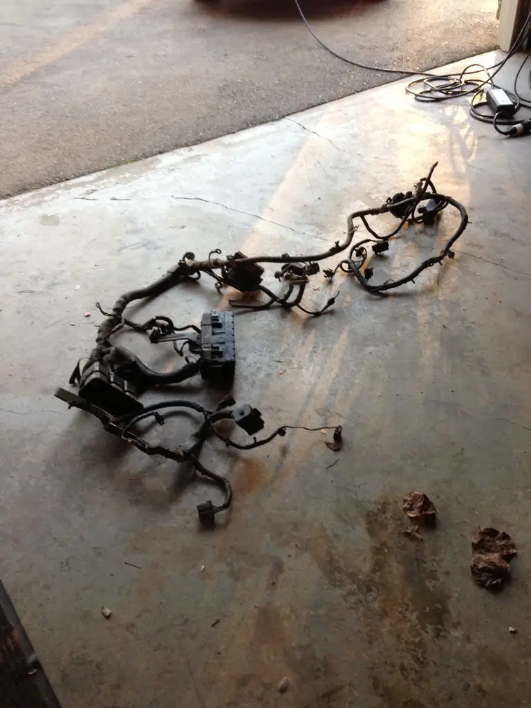

Motor bay wiring harness:
Nekkid:
