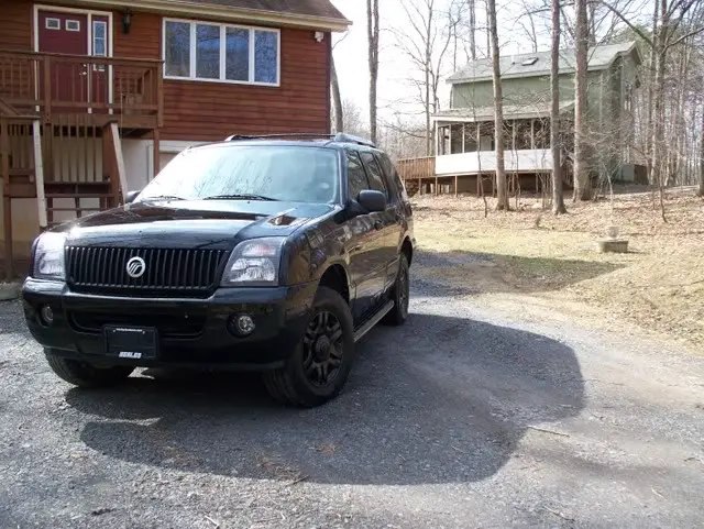

he's better off with an XLT bumper from an X that didnt come with the fog light option...a mountaineer bumper will leave him with holes where the fogs would be, i think there would be a gap for the different grille, and he'll have side markers.
Mounty Front:

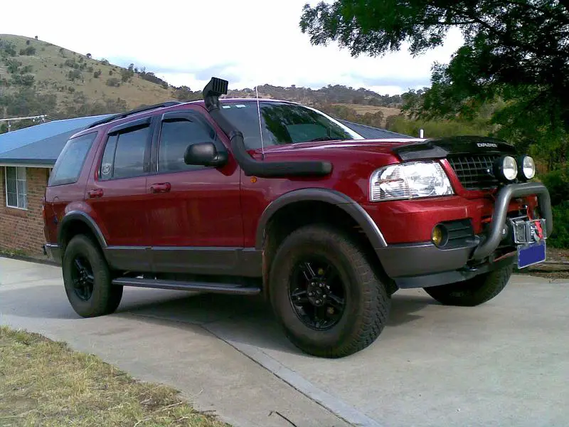

Ex front:
The top of the bar, and how it fits into the front fenders looks similar to me, but would need to be viewed side by side to make sure, I guess.
