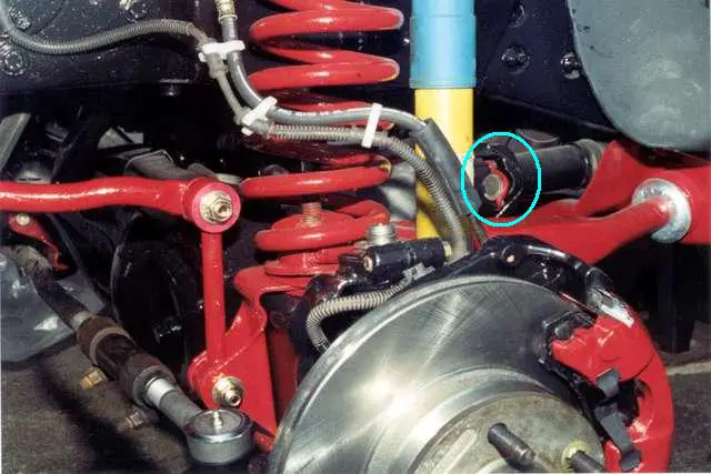

Hello i am trying to take out my front driveshaft and i cant seem to find out how to take it out.I see how to take the one out in the bac with the 4 bolts on each side but for the front i have no clue.Is there pictures on here that will show me what i have to unbolt to get it out
The front shaft is connected to the front diff by the small bolts that pass through the red bearing cap mounting clips as seen in the pic below. The joint at the T-Case connects via 4 similar bolts going through the T-Case flange to the double cardan U-joint.
