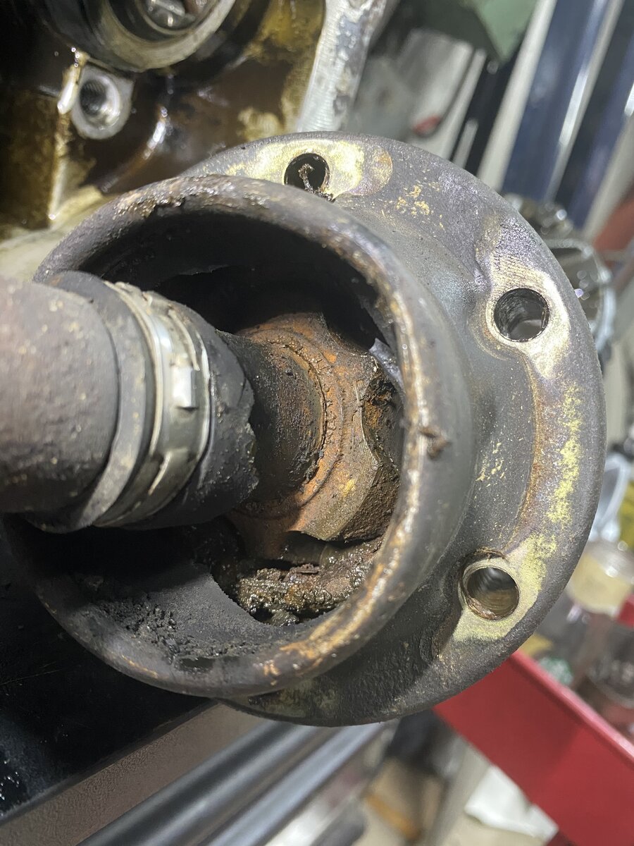

Well here’s what I found. The inside of the cv joint of the front driveshaft is pretty nasty and rusty. The ball bearings are dry and have lots of crud inside too. I’m guessing this was the issue. I’m going to replace the driveshaft along with some seals on the diff and tcase and go from there.
Lol yep, that’s your smoking gun
Well here’s what I found. The inside of the cv joint of the front driveshaft is pretty nasty and rusty. The ball bearings are dry and have lots of crud inside too. I’m guessing this was the issue. I’m going to replace the driveshaft along with some seals on the diff and tcase and go from there. View attachment 341626
Looks mint lol
