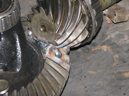

do you have a pic of where you have to weld
Here you go:
The picture above was a joke... :D
This is actually what you are trying to do:
Only change from the bottom picture (a great welding job!) would be to eliminate the welds on the cross pin so that you can still get the axle shafts out. With the cross pin welded like that, you are out of luck with c-clip axle shafts like ours! The cross pin needs to be removable so that you can push in the axle shafts and pop out the c-clips.
thats to make it a posi i was talking about where you welded the cap so you dont have to use the c clip.o and i have seen that first pic before!haha

Oops, I thought you were talking about the spider gears.
