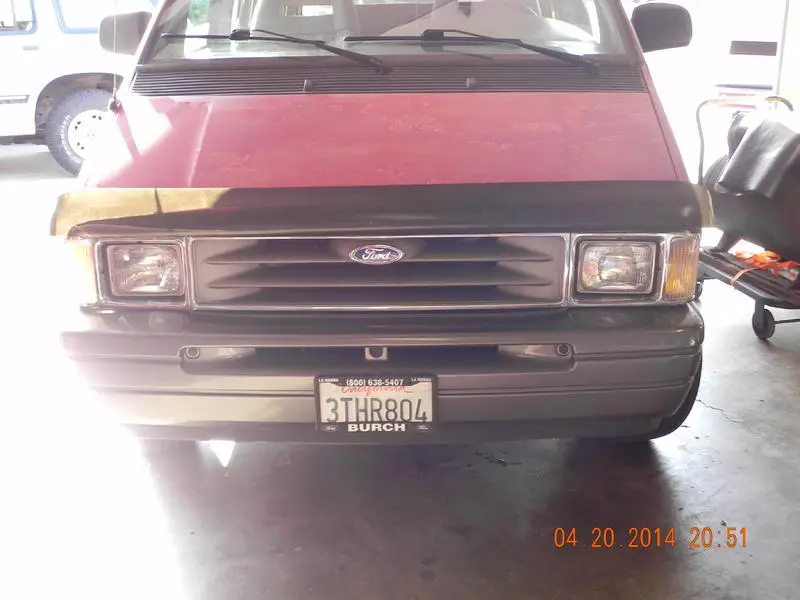

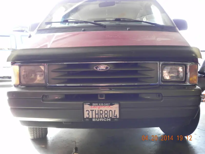

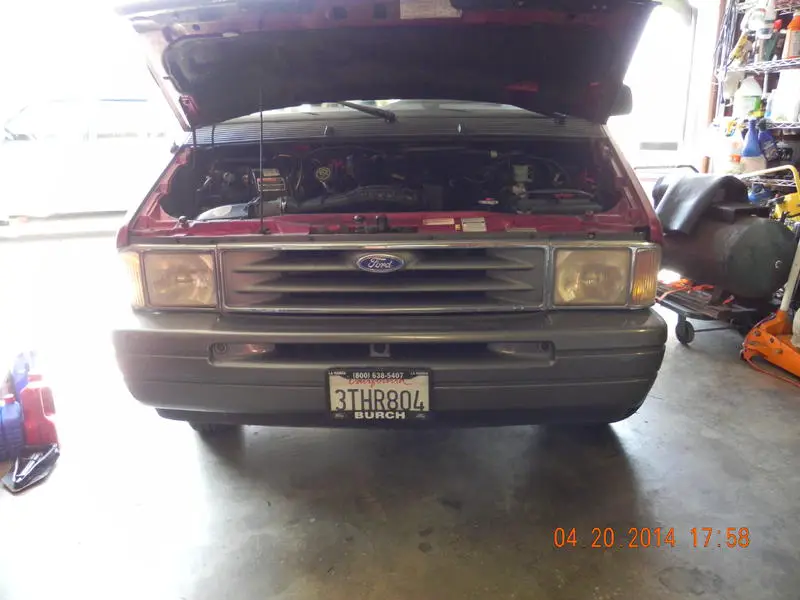

well it took me 6 months but i finely did the head light conversion from plastic headlight to the glass sealed beams and it was really easy and took about and hour and half for the hole thing and makes a huge difference in light and I'm running the lights i got from the junk yard van
it actually looks better than with the plastic lights.
thats the main reason why I changed them out I dislike the plastic look and they were all cracked and yellow
