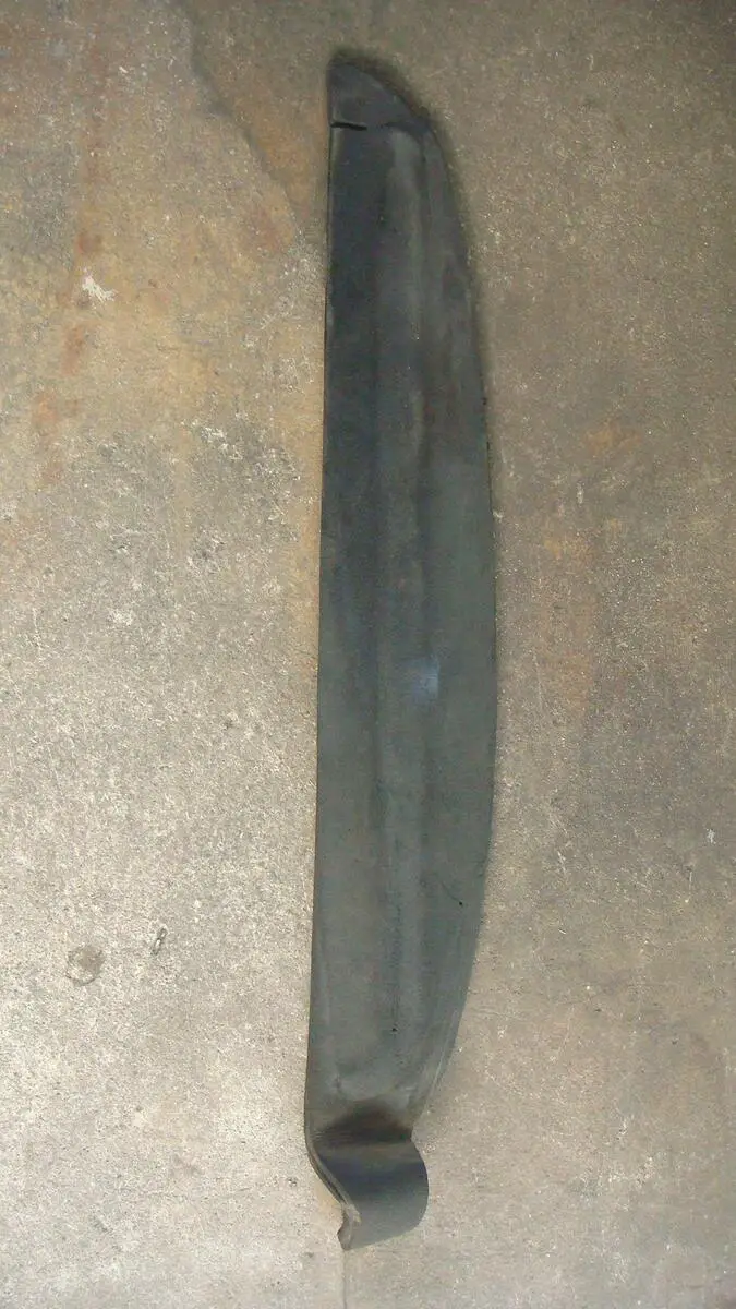

Accidentally pushed them both in while cleaning the door jambs. Don't believe they are held by anything except friction. Had to loosen the plastic fender liners for access and glued them with E-6000 adhesive. If you open your doors and see light coming through, it's a source for wind and road noise. Also dust and water. Surprising the difference it made reducing wind noise at highway speeds.

Good work. I discovered those in 2000 when rebuilding my 93 truck. Those do stop a ton of wind noise from getting in, I've saved a couple of spares from the JY, in case.

Swshawaii, you and Don are always "right on the money" about the things you post. I been trying for months to chase down wind noise in my '03 Sport. Just yesterday I was annoyed by all the wind noise while driving on the Parkway (Highway). I had checked the door seals and replaced my doors wind deflectors trying to remedy the wind noise. I even took off my drivers mirror to make sure no wind was leaking thru there.
Today, I checked my Sport today after seeing your post here Swshawaii, and found both sound absorbers to be out of place (damaged) and leaking plenty of sunlight. This means they both will be replaced and they had to be a great contributor to my mystery wind noise. So thanks Swshawaii again for taking the time out to share this info and your other contributions in the past . :thumbsup:

Appreciate your kind words mic98xlt. Quite honestly, two guys in this thread, koda2000 (Phil) and CDW6212R (Don) have contributed so much to EF over the years. Concise, hands on information that can't be found in ANY manual. Very grateful. Glad you found this thread useful, and hope it reduces your wind noise to some extent. I had a heck of a time getting the plastic fender liners loose until I found those "semi hidden" front bolts. Also a good idea to wear safety glasses when removing, It's amazing the amount of dirt and crud trapped in the liners. Keep us posted with your results and good luck!

I did order the liners from Ford Parts Giant and will post how it goes.

Are you buying the inner fender insulation, pictured here, or the aprons that lay over the shocks and UCA's?
Don, I am getting the foam fender insulators. I already have added on the engine full size aprons because I thought the open gap was way too big to be left open. I really think Ford degraded noise suppression and keeping the engine clean when they eliminated those aprons from the factory.
