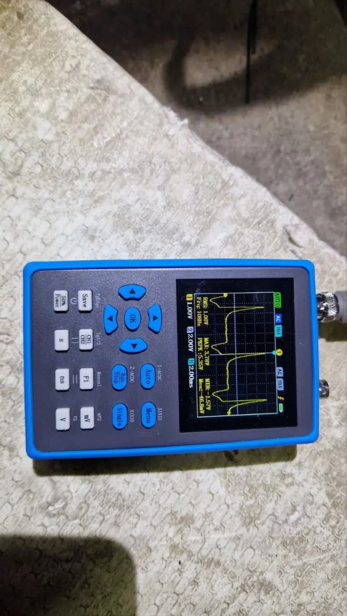

The problem is that, as you can see in oscilloscope photo, fog light receive PWM signal. I need switch off PWM or change PWM duty cycle. Fog lights not flickering if it switched on with stopped engine, then engine starts BCM send PWM signal to fog lights and it start flickering.

^ Where did you take this measurement? If between the driver board and LED array, I'd think your driver is failing.

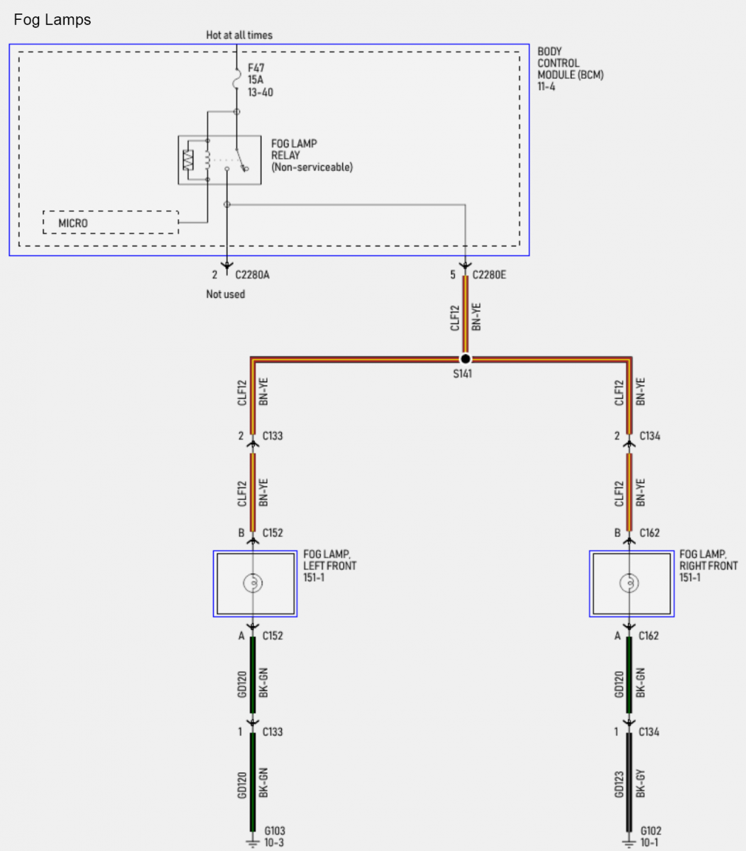

If this is before the driver, something is very wrong because an incan bulb drive would not be PWM at all, would be continuous 12V, direct battery feed switched on through the fog lamp switch and a relay. Ford has been switching some circuits from the old style mechanical relays to more modern, transistorized relays, and if that happened by '16, that may be where the problem lies and so the next thing I'd do is try swapping that relay with another of same, transistorized relay... except it may not be plug-n-play swappable (see below).
However on the wiring diagram I have for a '14, it shows the older style mechanical relay, but it's embedded in the BCM so not so simple to swap out, and yet it certainly shouldn't be rapidly cycling to product PWM, would be constant on, or off. I am wondering if you are just measuring residual switching noise caused by the LED driver circuit, is there really not any DC voltage near 12V present? I mean your picture just shows ACV.
The correct replacement part for incan fog bulbs conversion to LED will necessarily have a driver (or at least a series resistor if a bad design), and still the input for that should be 12VDC through the BCM, not PWM till after the driver.
This is from the '14 workshop manual:
I measure in fog connector with disconnected fog light
Did you measure for DC voltage? The circuit should be feeding the lights, about 12.6VDC engine off, more than that with it on, depending on the state the BMS is in to determine alternator charging cycle. What you measured makes no sense to be correct for the incan bulb so something is wrong in the measurement or the circuit, not in the Forscan setting.
charging voltage is 14+ V, with stopped and started engine fog lights feed is about 12.5V. Because started car fog lights voltage is about 12.5 V but battery charging voltage 14.5V it means that fog lights receive PWM signal and it can seen in oscilloscope photo.

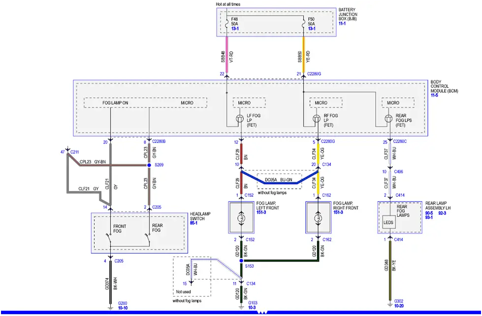

I replaced my front turn signal bulbs with LEDs on our 2018 Explorer. I had to install resistors to stop the hyper flashing of the LED. The BCM saw the blubs as "burned out" until the resistors were installed.
Below is from a 2018 Ford Service Manual.
from a 2018 Ford Factory Service Manual
