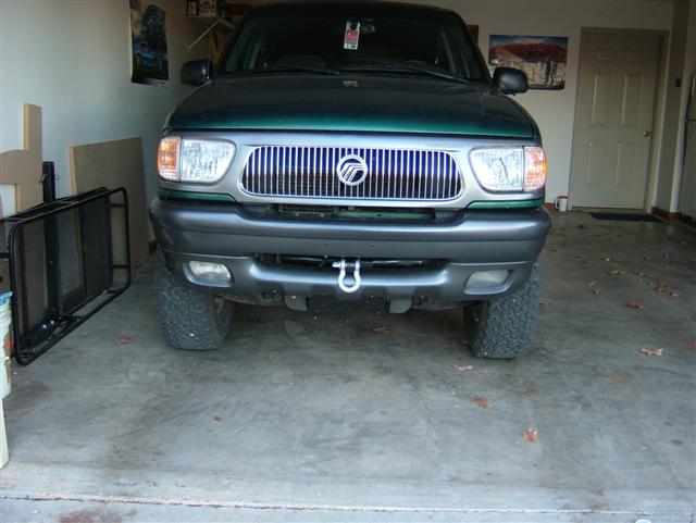

Hey guys sorry for the delay. Looks like to me its good clearance. Front tip of receiver is 11.5 inches, the cross member on x is 10.5 inches. I had to remove my tow hooks :( but I will make modifications to replace them and will make two small cuts in bottom air deflector flair thing to replace that. took about 20 mins to install. With the rack I have there's plenty of clearance, had it on the beach Wed. no fish, nice ride though. Oh one thing I used my own mounting bolts theirs was difficult
Looks good. Nice setup... I will have to get one now. Thanks for the advice.

I thought about doing the front receiver but after seeing the front shot, I think it looks to low. IMO

I quess it depends if u need one or not. Mine is still 1 inch higher than the front cross member. its a custom fit drawtite, so unless somebody makes u one thats the best ull find.

Thanks for posting some pics. Looks good to me. It is lower than I thought but I want to mount a bike rack on mine so a little lower is better I think. My only concern is if the rack and bikes will stick up to high past the hood and into my line of vision.
I went with the Curt reciever. I was able to get it local and it cost about $130 taxes included. Installed in about 45 min. There is one problem... I can't see the cooler and rack while driving.... The darn thing sits too low. I have some pics and will post when I get them out of the camera. It is nice having the cooler back.....
