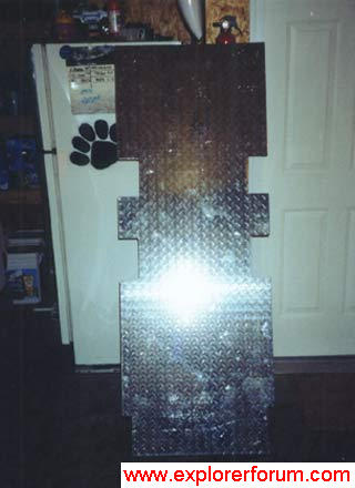

You will most likely need to have one custom made, or make your own. I made one to fit a 95+ a few years back out of aluminum diamondplate.
that looks great,good job with the cutting.I might try it and cut some sheets up.Where did you mount the panels to the body?

Hey JD, I like the design, where and how did you fasten it, and did you add any structurals to the backside or jsut go with the 1/4" DP

As for mounting, it mounted to the tranny crossmember where the torsion bar covers mount, the main engine crossmember and the bottom of my brushguard. I made a couple of tabs to mount it to the brushguard and then reinforced the guard to frame mounting.
