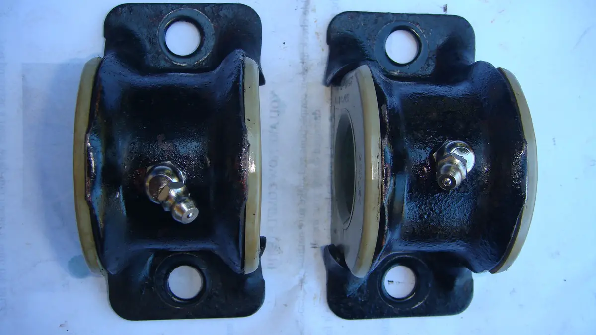

Polyurethane bushings are much more durable and perform better than OE, however they tend to squeak if not kept greased. I've seen Energy Suspension sway bar bushing kits that include a new bracket which has a grease fitting in it. That would be the way to go IMO.
Example:
Tried the ES universal frame brackets with grease fittings. Great idea, but they are about half the thickness of the stock brackets and bend very easily. Decided to drill and tap the stock front brackets to install 1/4-28 zerks. Would have done this before buying the ES brackets if I had known the OE bushings had square "pockets" to retain grease. Rear brackets are a different design and the bolt spacing is wider than the fronts so the ES universals won't work.
