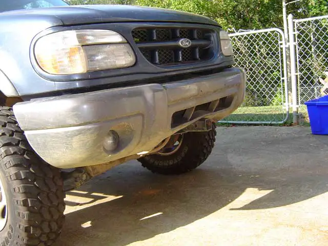

this is what it would do.
i just had to cut a little notch off the bottom and just kind of press the bumper over it. i have a license place bracket deal that fits in there and hides it too.
