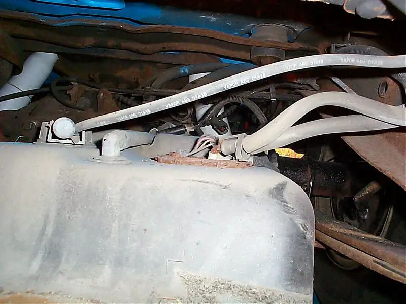

where does the vent hose go from the fuel tank? i'm installing my fuel tank again and didn't see where it came off. i know the lines, and the fill tube and the fill tube vent, but theres a third line. where does that hookup? i'm guessing it goes to the carbon canister, but wheres the hookup?
It should hook into the EVAP system

hey you wouldn't know where the evap hooks up underneath?
this pic help ?
hose on the left should be what you need to look for

yea i know where it is on the tank, but where does it go to on the frame? its hooked up on the tank side
2nd pic
ok here it is on the frame on top just behind the brace that holds tank strap not really alot of pressure in the hose so if you need to run a longer piece of flex gas line their to make it easier on you go for it :)
alright thanks. it seems to start up a lot easier now. and absolutely no smell of gas whatsoever!
