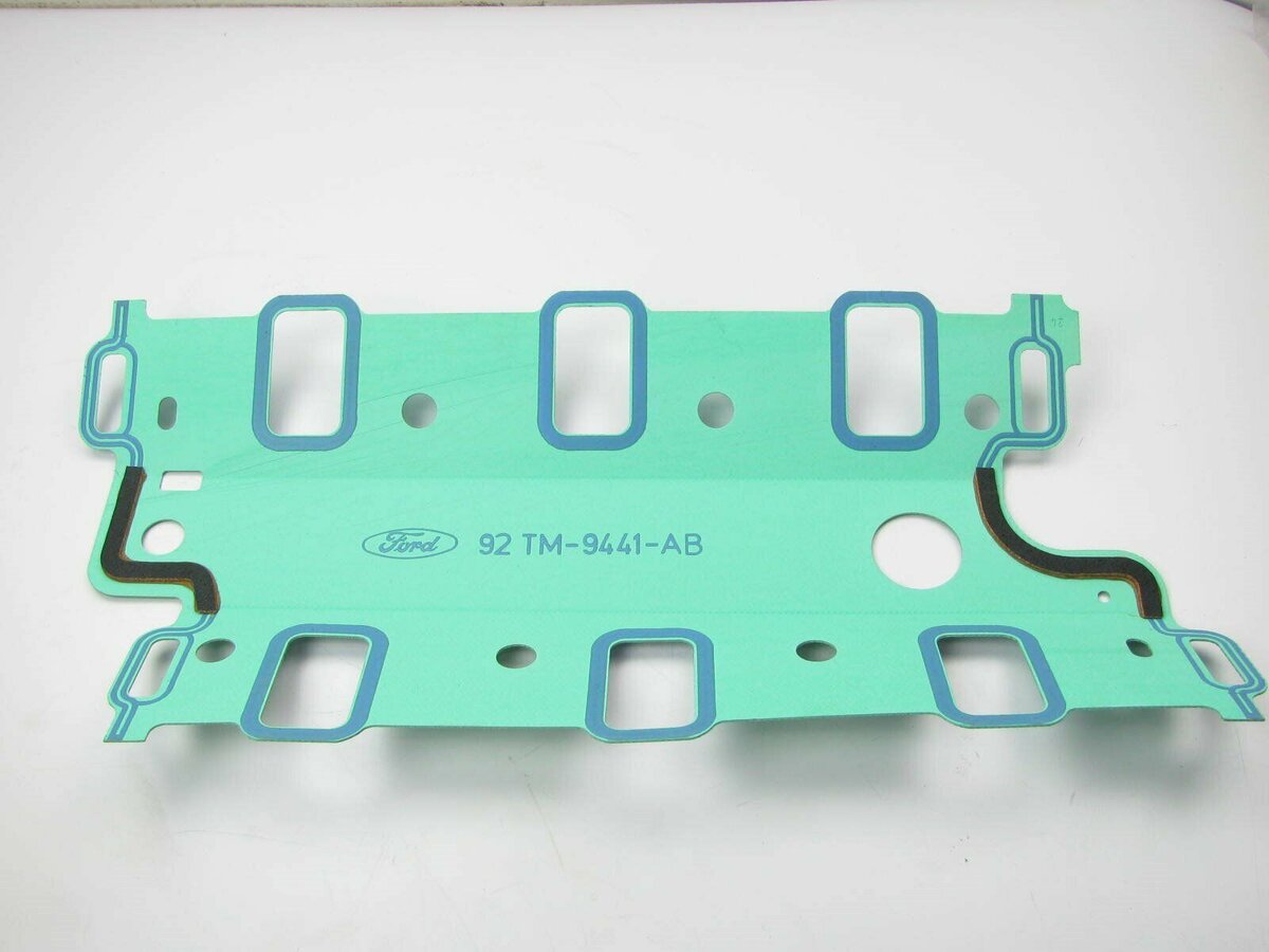

I figure I might as well just replace all the gaskets since the original Ford ones have given many others tons of problems (which I attribute to shoddy manufacture and a lack of proper torque everywhere) and this would make it "problem free" with all the "known" intake issues resolved and taken care of.
If I am not considering this properly, let me know... But I figure making sure it is assembled properly with better gaskets would be a way of being certain it was taken care of.
