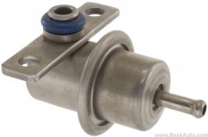

Hi again, still in search for a solution to my very poor performing Explorer. I have the 1999 4.0 SOHC with the fuel pressure damper mounted to the firewall. Question:
Does this damper have any vacuum lines/hoses that are supposed to be attached to it?
Funny think is I found this little black rubber plug on the ground in my driveway. Width of a nickel, length about 1/2 inch, and has a nipple that fits perfectly on the end of the left side of the damper. I have no idea if that plug goes there????? Seems like something should attach there???? I can't find any pictures of the damper because apparently no one sells it.

has vacuum port
Yes, the fuel pressure damper has a port that connects to intake manifold vacuum.

The fuel pressure dampener is located on the fuel rail,
not on the firewall. Maybe that's something else that
you're referring to...???
Hi Runnin' - Apparently they switched things over starting in 1999. This is what StreetRod said in another thread:
The fuel pressure regulator on the fuel rail was replaced in 1999 with a fuel pressure damper when Ford switched to a returnless fuel system. It's between the firewall and the coilpack
The pic Streetrod just posted does not look like what I have, so I will have to go look again for something similar to that pic. What I have mounted to the firewall must be something else. He said it was between the firewall and coil pack - I assumed it was mounted to the firewall since there isn't much room between the firewall and coil pack.

Your 1999 should have a returnless fuel system that is identical to a 2000 model. Rock Auto still sells a Standard Motor Products fuel pressure damper P/N FPD80 for a 2000 but the cost is a prohibitive $260. There is one Airtex unit still available on eBay for $77: http://www.ebay.com/itm/Fuel-Inject...ash=item20fd60bc6d:g:jQcAAOSwHnFVn~AK&vxp=mtr
