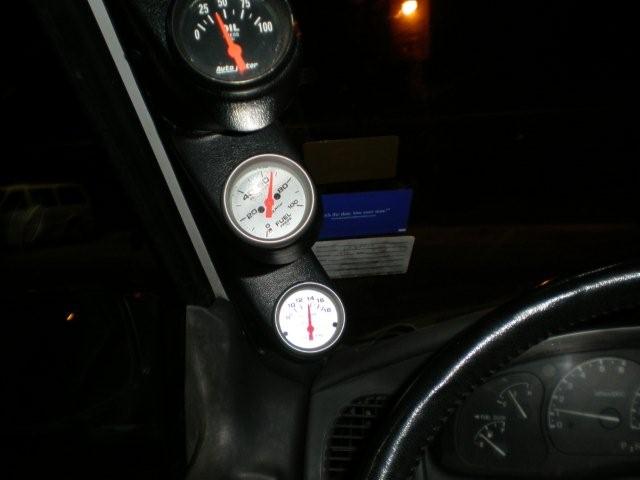

I have used an Autometer electric fuel pressure gauge mounted inside my vehicles for years...On this vehicle I mounted three gauges; Fuel pressure, Oil pressure, and voltage in the A-pillar...The fuel pressure gauge has a sending unit that attaches to the 1/8" NPT fitting on the fuel rail...I also installed a tee on the Schrader valve so I could also relieve the fuel pressure from the system...I needed a fuel pressure gauge since the way the engine would not accelerate under even moderate throttle made me think the fuel pump was not delivering adequate fuel...The fuel pressure was dropping as the demand of more throttle occured...The spec is 65-72 psi and when the pressure drops below 50 or so psi the engine will not run well...The pump was working but the tank was providing leftover varnish to the inlet side of the filter and this was restricting the volume of fuel to the engine...The fluctuating pressure gauge told volumes about when to change the filter and ultimately when I had enough of this clogging and decreased performance...It was so bad the PCM triggered a random lean misfire occasionally and top speed was limited to under 50 mph until I changed the filter...
This is my solution for gauge placement...

that looks awsome! i would love to do something like that. how much did them gauges cost ya? and was it difficult to run all the lines to hook up all that?

Gauges are Autometer...
I don't remember the exact prices but I bought them through Summit Racing...
Installation was a matter of finding a source for the fluids I wanted to monitor then tying into that particular system...
For the fuel pressure gauge, the sending unit fits onto the Schrader valve...I removed the valve from the fuel rail and installed a brass pipe and tee...Then I used a bushing for one side ofthe tee to hold the schrader valve and screwed the sending unit into the other side of the tee...I used liquid teflon to seal the threads on all connections...
For the oil pressure gauge I removed the Ford oil pressure sending unit...Again I installed a brass pipe into the threaded hole in the block and installed a brass tee on the end of the pipe...Then I installed a new Ford sending unit on one side and the Autometer oil pressure sending unit on the other side...
The voltage gauge was the easiest to install... I had to run the wires from each sending unit to the gauges and power to the lights in the gauges and I simply ran a switched +12 and a ground to the voltage gauge...Tied all the wires together in a bundle behind the pod unit on the A-pillar and cleaned up the installation and tested it...
Since no one makes a 3 gauge A-pillar pod for the Explorer I made my own... I bought 2 2 gauge pods and cut one in half...I attached the single pod to the 2 gauge pod by using hot glue and MEK to fuse the parts together into a one piece unit...
