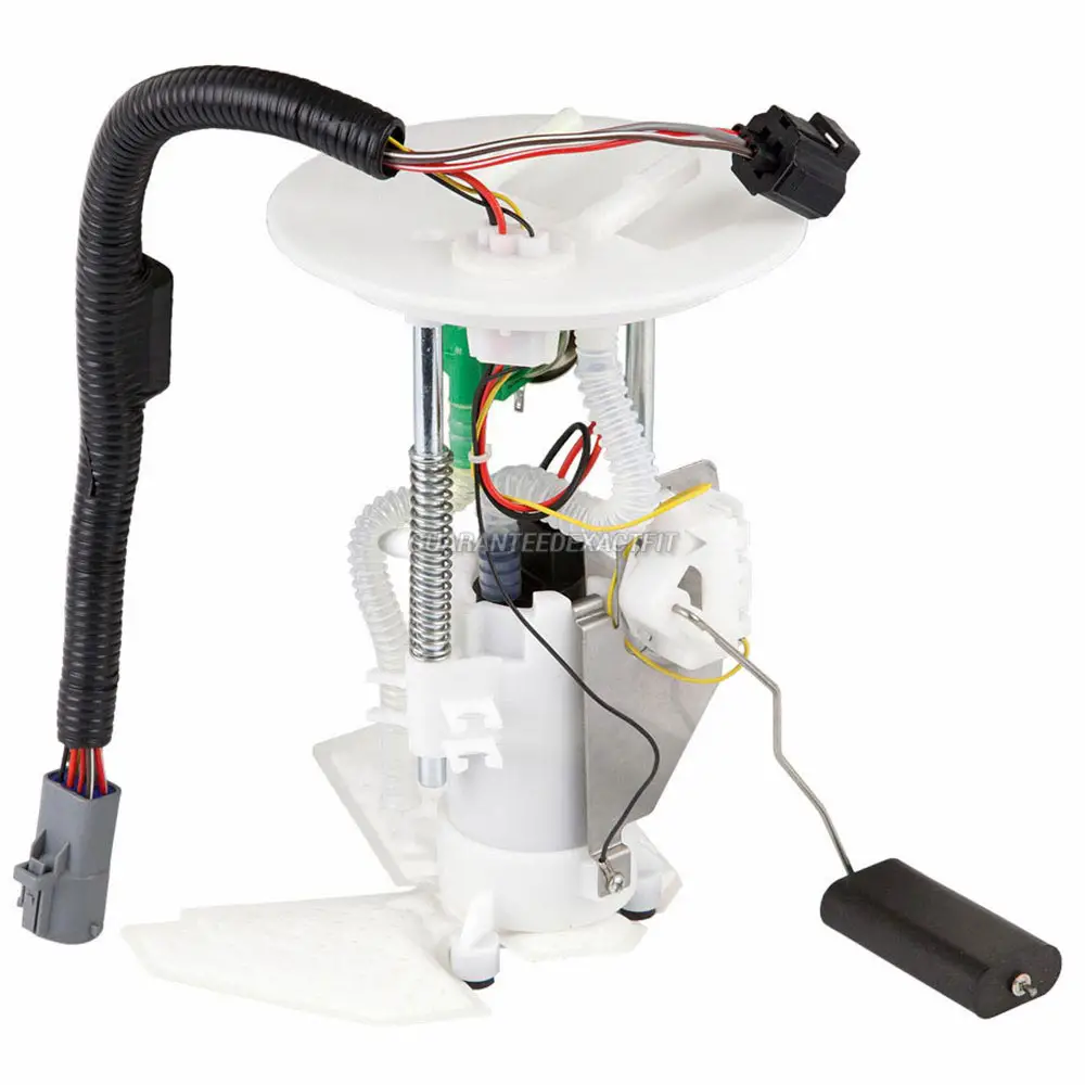

Ok I bought my explorer 6 months ago and the fuel gauge never worked so I replaced the entire gas tank sending unit and all and it still didn't fix the gauge. So I thought it was the gauge. Got a new cluster and it still doesn't work. So I put my old cluster back in and took apart my old tank and fuel pump and tested the sending unit for ohm resistance. And came back with no resistance thru all arm levels. However there is this sensor or module thing attached to the sending unit wires. I removed this and then tested the same lines and bingo I got readings that varied as I raised and lowered the arm. I jumped the connector
for the sending unit and raised and lowered the arm and the fuel gauge moved up and down. Now my question is what is that little module thing, and can I remove it from the one I just put in and not have any issues? Any help is greatly appreciated thank you. You can see it tapped around the wire loom in the picture a few inches from the connector.
