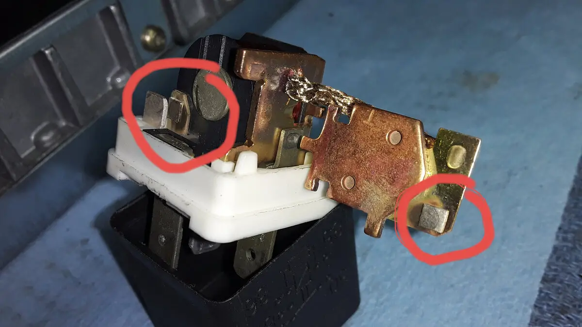

Took her to dinner with no issues. Just so happens I was monitoring TFT with Forscan (to double check I installed my external filter right) and she popped a P0230 fuel pump circuit code. Trims looked great. Weird.
Got back in after dinner, turned key to on and the check engine light was flickering. No method to the madness. Tach needle was twitching too. Clicking from the engine that I couldn’t isolate, but the FP relay was also clicking away (truck not running).
I swapped the FP and horn relays and everything resolved. Truck took a little cranking to start, but ran great with fantastic trims the whole way home. No codes returned, including the 0230.
I’m thinking that relay was on the fritz and possibly not holding, but I’ve never seen the flickering check engine and bouncing tach before.
I’ll likely check idle fuel psi tomorrow anyway.
Thoughts?
