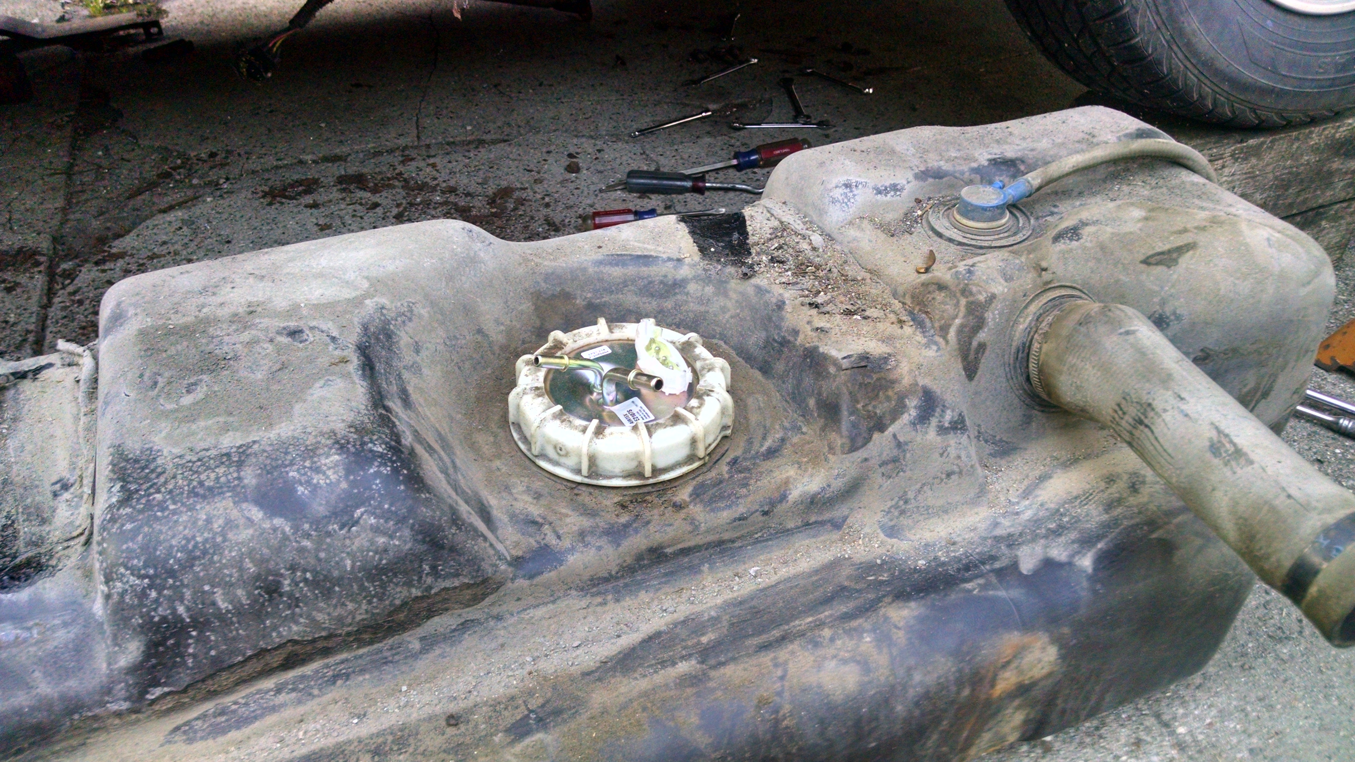

Just wanted to say, Ford hit the mark with the areostar fuel tank and pump. This was so easy to change, even on my rust pile of a van. I was expecting the metal lock ring that just folds up upon removal and the rusty tank tangs that never hold the pump in place again, without a prayer... similar to my explorers.
Now i just got to order some tank straps and get some new bolts and put this thing back together. I think I'm gonna replace my intermediate park brake cable while its easy to get to.

Finally got the together. It's been a busy couple weeks. The tank straps I got fit perfectly. They were only about $25 for the set. This was probably the easiest fuel pump I've done. Tank had a gallon in it when pump went bad. Total opposite of whats normal!
