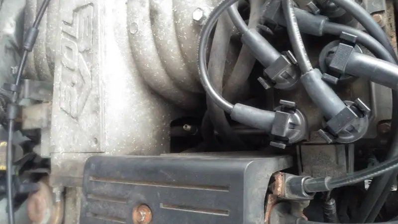

98 Explorer AWD 5.0 I'm trying to diagnose a crank, no start. I need to check fuel pressure. Does anyone know where the schrader valve for the fuel rail is. I can't find it. It's probably hiding behind a bunch of rust.

Right behind the coil packs
Nice @nameskreen
98 explorer can have one or two fuel lines
Yellow/orange or White/off white injectors
Two fuel lines is a return style system, orange injectors
Single fuel line is a returnless system, white injectors
96-98 return system runs about 36-42 psi rail pressure
98.5-01 Returnless runs 62-68 psi
