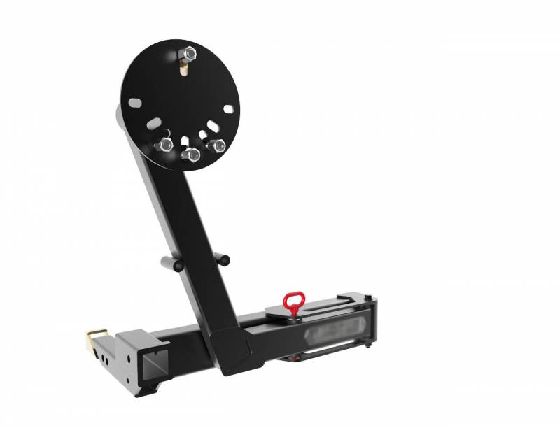

Example of hitch mount spare tire carrier.
Here is the problem with a hitch mounted spare, it significantly loads up the limited weight carrying hitch ford puts on its Explorers and increases rear end sag. Those hitches are limited to 500 pounds vertical load and the torque wiggle that a spare tire with a long vertical support puts on that hitch could be damaging.
A full spare mounted low, either inside (if the 3rd row seats could be moved like on a hinge) or outside from the bottom, shortens the torque arm, doesn't load the hitch, and keeps the center of gravity low (which as you know is important on a 4wd with a higher ground clearance)
The explorer is a low ground clearance car based SUV. If you search google images for "hitch mounted spare tire carrier", you'll see how many people run hitch mounted spares/fuel jugs/tools/etc... on real 4wd vehicles with high ground clearance and/or while trailering. If you prefer to jack with the interior or pound metal underneath the vehicle and potentially compromise the structure/crash-worthiness of your vehicle, have at it.

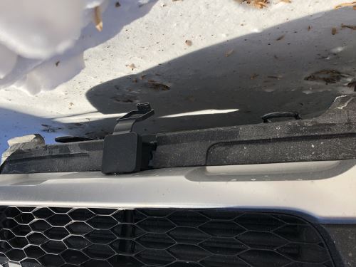

non-eb have the option to add a front receiver (curt c31052) where you can add a spare tire carrier or any other hitch mount accessory (may block front sensors)
