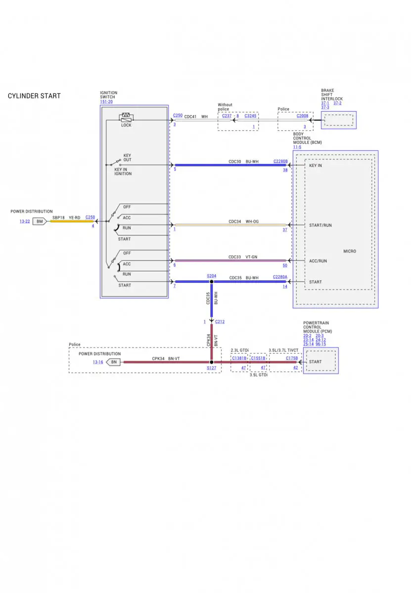

Since your fuse 18 has a different function, I'd want a wiring diagram and what I have wouldn't apply to a '16-'17. Considering it's the ignition switch, I'd wonder about wiring getting frayed due to steering wheel tilt or chafing, or is the PIU ignition switch on the dash instead of steering column? If so then I'd take the ignition switch out and check for wear/damage and whether any special equipment was torn out and left behind a wiring mess.
You could check the '14 wiring diagrams in my sig or the workshop manual troubleshooting but there would be some guesswork involved too since it seems the circuit changed... but where the connector part # and wiring colors are right, the circuit is likely to be the same.

Fuse 18 is coming from “BM” to the ignition switch
17 and 18 share the same fuse but each is its own circuit (Left 17, Right 18). 18 power the ignition switch on the 2016 and 2017 PIU.
So remove the knee bolster and metal plate behind that. Inspect the ignition switch and steering column wiring. You’ll probably find old wiring shorting or wiring not heat shrink after it came out of service.
