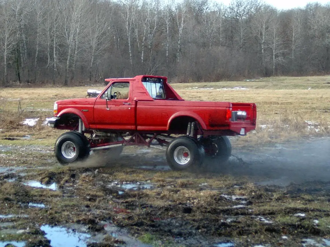

I run full Nitrogen shocks on "Crazy Too". A little more pricey, but nothin better......... :D
http://www.knight-stalker-ent.com/
14" stage 2........
Steve of K-S, also builds these and are also equipped with his Nitros
