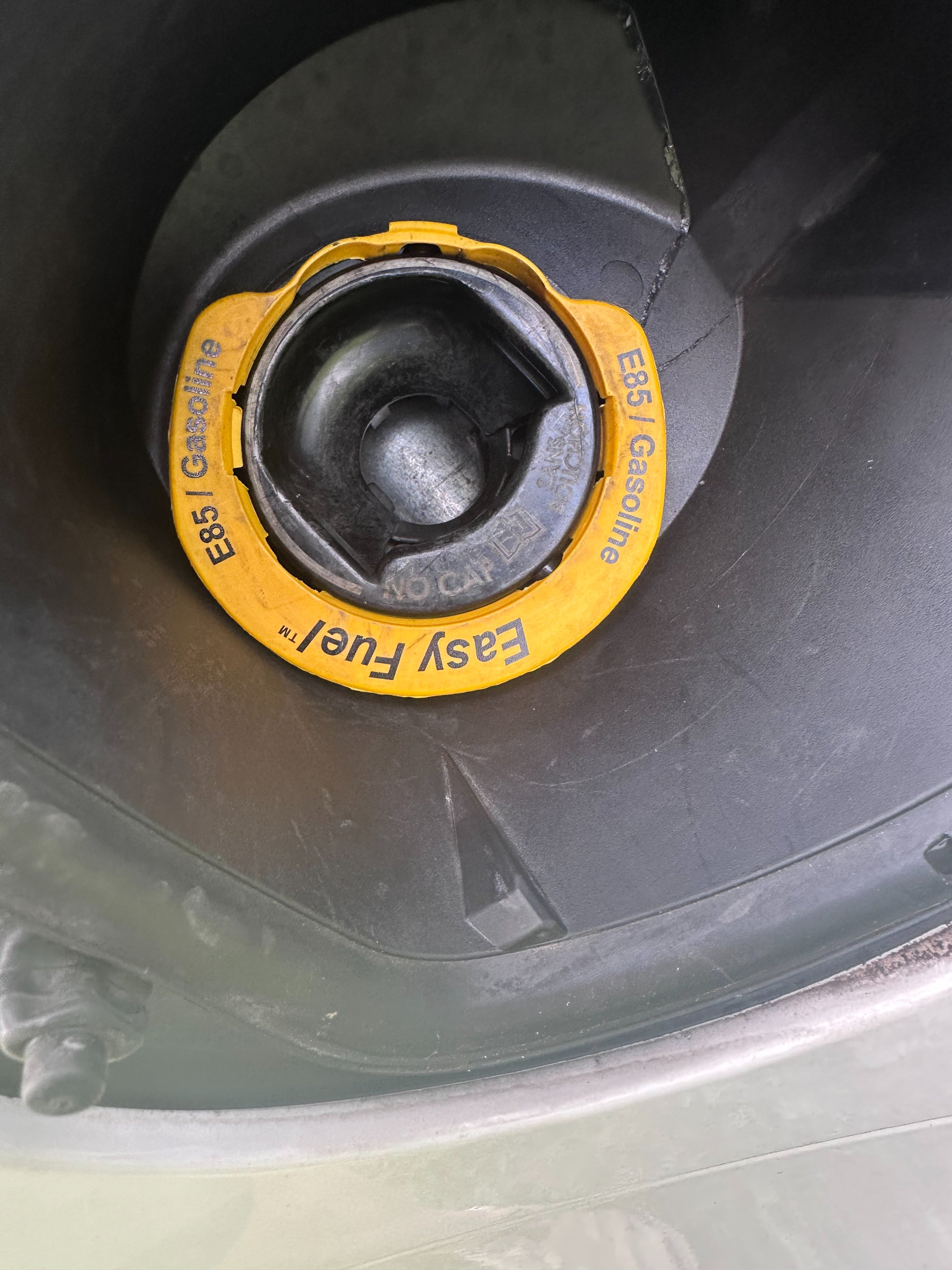

Hello ProjectSHO89,
Attached are photos of the problem. The "flapper valve" is either missing or stuck. I couldn't make it move at all.

PETER,
FORGIVE THE ALL CAPS..I HAVE ARTHRITIS AND TODAY IT'S WORSE THAN USUAL SO NOT GOING BACK AND FORTH BETWEEN CAPS AND lower case helps me alot.. ALSO, I'M NOT FAMILAR WITH POSTING HERE.
THE PHOTOS ARE AT THE BOTTOM OF THIS POST...AT LEAST I CAN SEE THEM AS I TYPE THIS. IF YOU NEED THE PHOTOS AGAIN I'LL SEND THEM.
I TRIED TO PUSH THE FLAP BUT IT WON'T BUDGE. ALSO, THE YELLOW RING I'VE NEVER SEEN BEFORE.

Hi Bill. Thanks for the reply. If you tried to open the flap using your finger or some tool, that won't work. You need to insert the pump nozzle or the special filler tube that should likely be in with your spare tire. Those will open the flap. The yellow ring indicates that you have a flex fuel Explorer that will run on regular gasoline or E85 fuel.

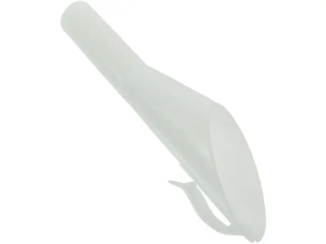

This is what you are looking for it should be with the spare tire.

The funnel stored with the spare tire worked! Thank you very much!

That means the pump nozzle should also work to open the flap. I'm guessing this is your first experience with the capless fuel system.
It is designed this way to prevent the average person from getting access to the fuel, although it can be defeated if you know how.
Peter
If you look down into the neck of the filler tube, you'll see two or three "fingers" above the flapper valve.
When you insert the nozzle or the adapter funnel, those "fingers" are pushed outwards and the underside of the fingers release from under the flapper allowing it to rotate downwards on its hinge, allowing the nozzle or funnel to be inserted fully.
