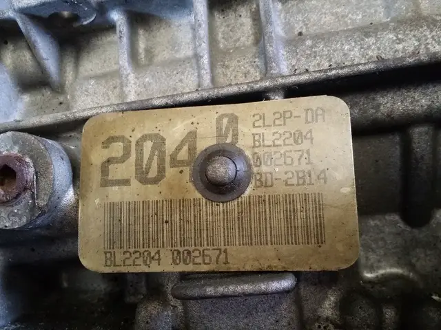

ok after much looking around i think its a 5R55W but still not 100% where would i look on the gearbox itself to find out or could anyone confirm ?
There’s not a transmission code on the drivers door jam tag?
2002 used both, the 5R55W and the 5R55S. The 5R55W was used up to 3/3/02 and the 5R55S was used from 3/4/02.
The W and S were basically similar physically, and can interchange, EXCEPT second gear ratio was not the same in each, all other gears the same. Therefore use of the "wrong" one would result in confusing the PCM regard shift speeds in 2nd gear.
The tag on the transmission could be used for identification.
where would i find that? hoping its not on the bits that went bang lol.
It will be on the side of the transmission. It could look like the tag in the picture or be a sticker.
