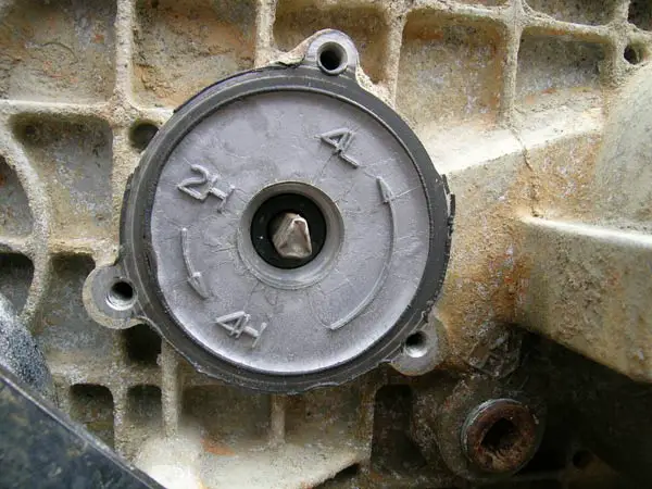

I just swapped in an electric 1354 tcase from a 98 ranger. everything bolted up fine and the selector motor from the 4405 bolted right on and has the same range of movement as the one from the 1354. Now the only problem is getting the dash selector to work. It seems the dash selector is run through the GEM behind the radio. The shift pattern on the 4405 is H-neutral-L in that order. The pattern on the 1354 is 2H-4H-4L in that order. The question is can i swap in a GEM from say a 2000 ranger with electric shift 4X and power windows? I can get the selector motor to turn its full range from 2H to 4L but how do i get it to select or stop at 4H in the middle?
thanx dave
I thought the 1354 elec was 2H, 4H, unlabelled Neutral, and 4L (image beloooooow) --- where as the 4405 is 4H, Neutral, and 4L.

yeah it could be. i shifted it by hand through the ranges but i wasnt really searching for an unlabeled neutral so i'm gonna try to find it tommorow. If that is the case maybe i could make the selector motor stop there on demand also lol. Any body have any ideas on the GEM swap? I can always slid under and switch it manually but i'd rather not and i'm not quite sure how water and dir proof the seal is on the selector shaft.
