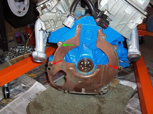

doing the heart transplant this weekend, Ive been a ford guy forever, but I really hate this vehicle. How do you get the top 4 bellhousing bolts out? Thats my job this morning, then the engines ready to pull. The internals are so busted up the engine wont crank over enough to get all the torque converter bolts out, so Im going to have to pull it with the engine.

I don't know about your 3rd generation but on my 2WD 2000 Sport I used wobble extensions working under the vehicles with the extensions above the exhaust system. That may not work on your vehicle. If the intake manifold is removed you can probably sit on the engine and get the top two bolts.
If the splash shields are removed you may be able to get the lower two bolts.
ok, I took the engine mounts off and lowered the motor as far as I could, then it wasnt as bad to reach, its all back together except for the intake, its full of metal chunks, I really wanted to get it started last night, but need to see if I can clean the intake out enough to trust it or not.. Ill upload some of the carnage pics from the last motor, haha.
