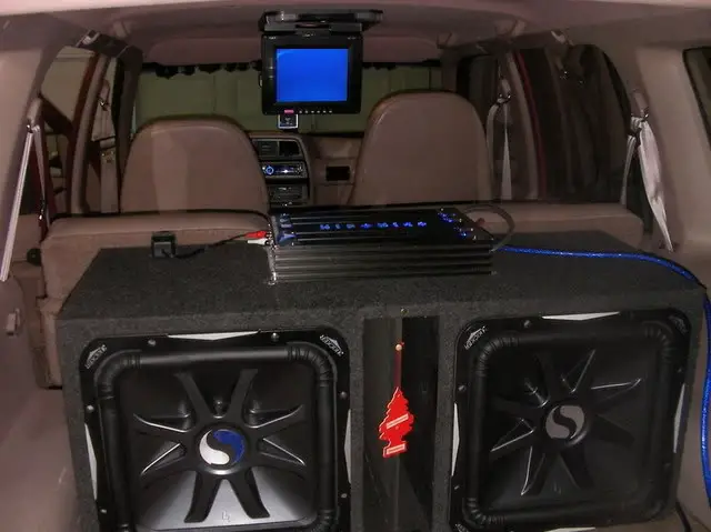

Pics of mine
LMFAO Yea, I seen them with a bronco, add like a 60" FLIP-OUT tv, when you rolled the glass down in the back hatch, a tv came out, then flipped up, like those flipout headunits
damn. thats pretty nice looking. Definitly like it. And those subs look sick. Im planning on getting dual subs within the next month...just waiting for the extra cash to flow in
