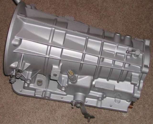

Every transmission should be degreased and washed before you start. Why ? because it will make working on it much nicer..... and set a tone of cleanliness you should follow. Me ? I prefer to do a really good job and pressure wash and paint the case.It just serves for me to tell me to stay clean and when I am done the transmission is something I can be proud of. Here is the case, all cleaned, sandblasted (It gets washed several times as a precaution after blasting) and painted.
the drums inside need the glaze taken off. Sandpaper is good, a sandblaster... hmmmm ... trying this followed up by 150 grit carbide.....
