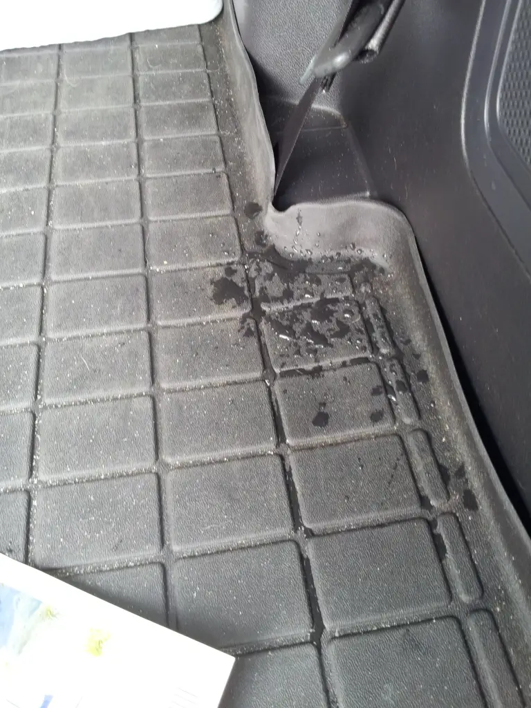

Ugh, now I need to bring it in to get another issue fixed.
Roof seam from what others have reported, looks like they need to gunk it up a bit :)
good luck

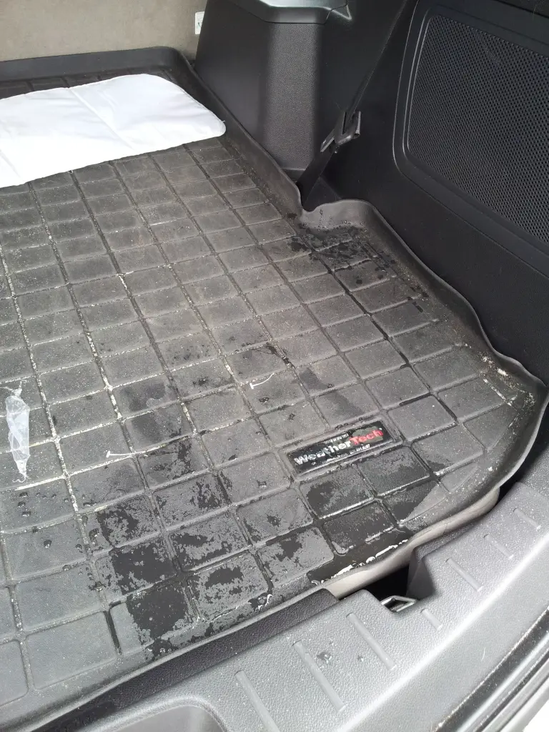

Looks like the weathertech was doing its job though :)
No, the water ran down the seatbelt, and the floor below the seats is soaked.
I had this leak in the same place. Was a seam around the back hatch but it ran down the headliner until it hit the rear right seat belt and the glass. It took my dealer two weeks to find and fix it. They have a smoke machine that shows leaks and actually found a bunch of them.
