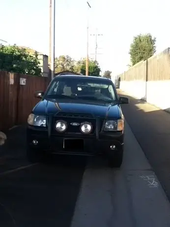

Thank you guys so much for your help, yeah now that i look at it they were pretty silly questions but just wanted to be sure. Thanks rookie i went out and bought some larger connections and liquid tape to make the install easy. I will be working on them tomorrow and let you know how they go.
Thanks guys, got em installed and heres the final product.
