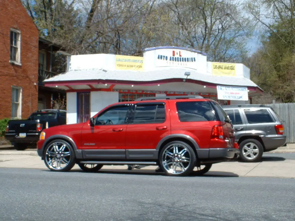

im putting 22 or 24 on mine and droping 1.6 inch this is a pic of one with 24s and lowered 1.6
I live in FL and drive on a lot of dirt roads for work so I'm stick with 20's. The extra sidewall gives it a better ride anyway. Nice ride though.
i dont drive mine much so the bigger the better no dirt roads for me car show only
Those are Sweet!! I keep checking the salvage yards or other places around me hoping someone is dumping a set of those!!

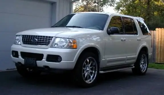

Here are my 20's
I like those wheels a lot. they are from sport trac, correct?
where did you find them? the prices are insane on ebay.
